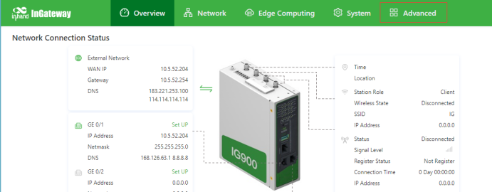

Click Advanced to login to advanced configuration page of IG902, you will need to enter the same username and password of IG902 in this page at first.
691×270 64.7 KB

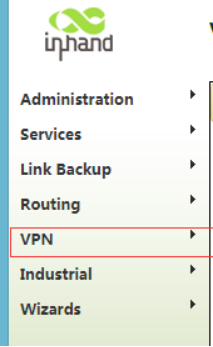

The VPN configure page in IG902 is the same with IR915.
