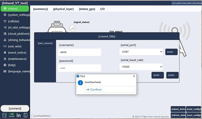

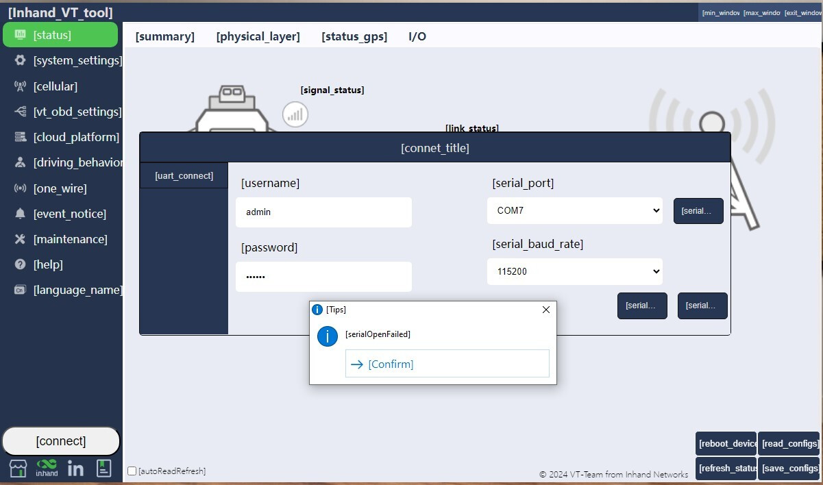

What should you do if you encounter the "serial Open failed" error when using the Config Tool?
Setup:

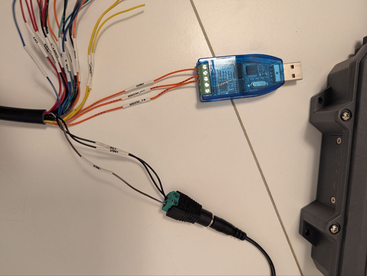

Power the VT device using an external adapter via the 26-pin all-in-one test cable. Connect the VT to your computer using a USB-to-Serial cable.
Issue:

    Ensure the RS232 connection between the VT and the USB adapter is wired correctly (Cross-over connection):
    • Rx to Tx
    • Tx to Rx
    • GND to GND

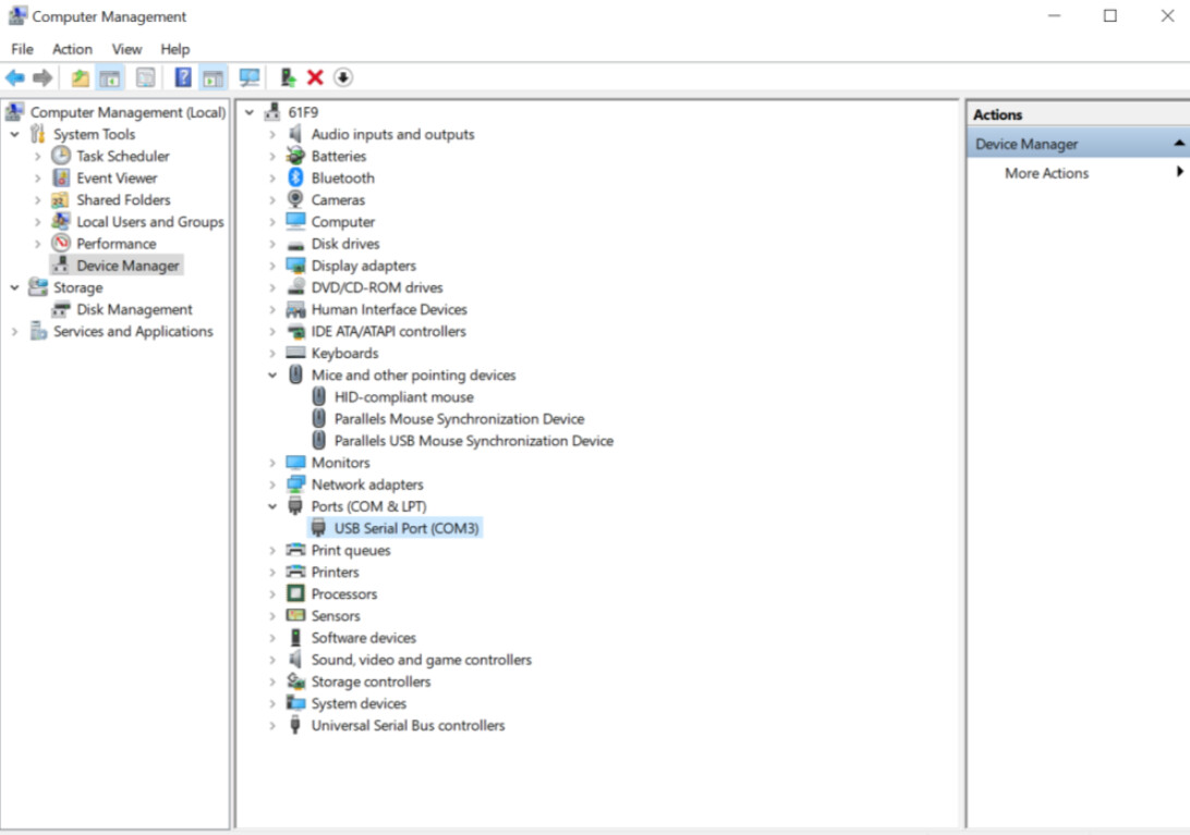

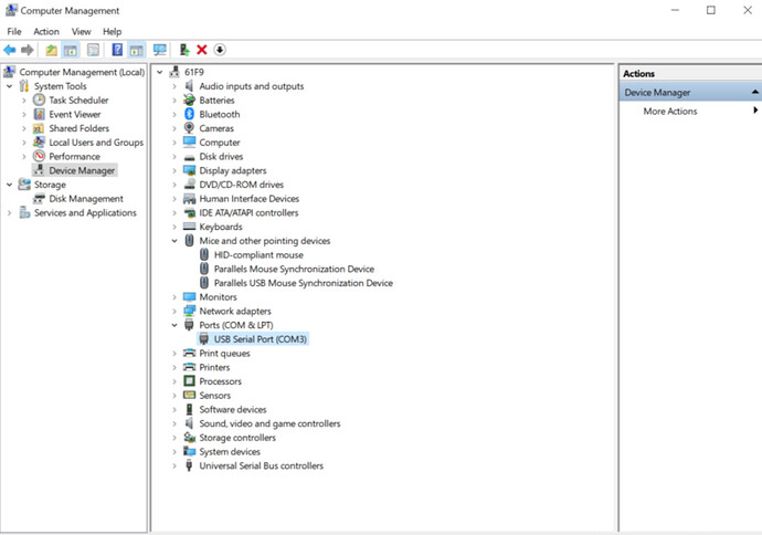

  3. Check PC Recognition (COM Port):
    Open Device Manager on your computer. Expand the "Ports (COM & LPT)" section and verify that the USB-to-Serial adapter is recognized and assigned a COM port number (as shown below).
