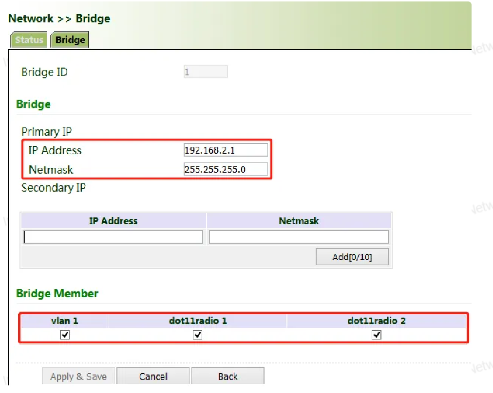

Method for modifying the IP address of a bridge port and bridge members:

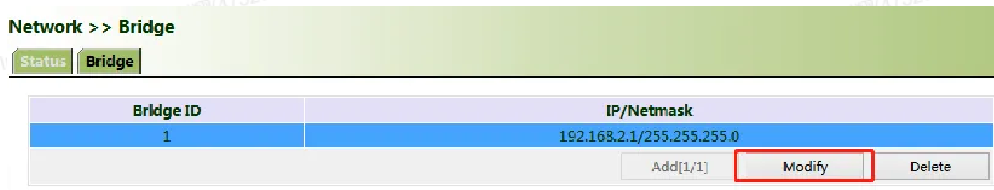

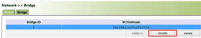

1. Click "Network >> Bridge" and select "Bridge >> Modify".
2. Modify the IP address of the bridge port or bridge members. Among the bridge members, dot11radio1 and dot11radio2 are Wi-Fi 2.4G and Wi-Fi 5G ports respectively.
