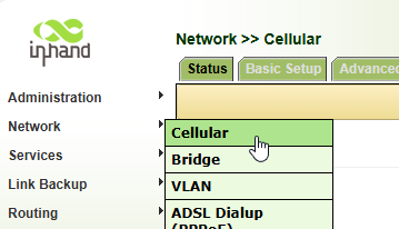

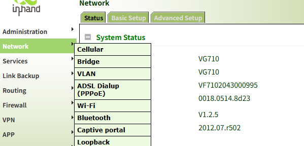

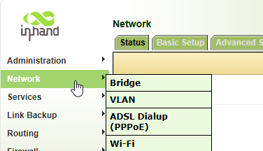

I also don't have anymore Cellular topic in network menu:
Before update:
After update:
How can I recover cellular fonction on my router ?

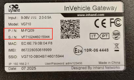

Thank you for your inquiry. To assist you further, please provide the Serial Number (S/N) and Part Number (P/N) of your device, which can be found on its nameplate (see example below). Note: If the P/N begins with M-XXXX, this model is not compatible with version 1.2.5.

P/N: M-FQ09
S/N: Vf7102446015921

I tried different browser, clearing cache and private mode, same problem

We would like to inform you that the M-FQ09 model does not support firmware version V1.2.5. To assist you further, please kindly provide us with your email address, and we will send you the detailed recovery procedure promptly.
