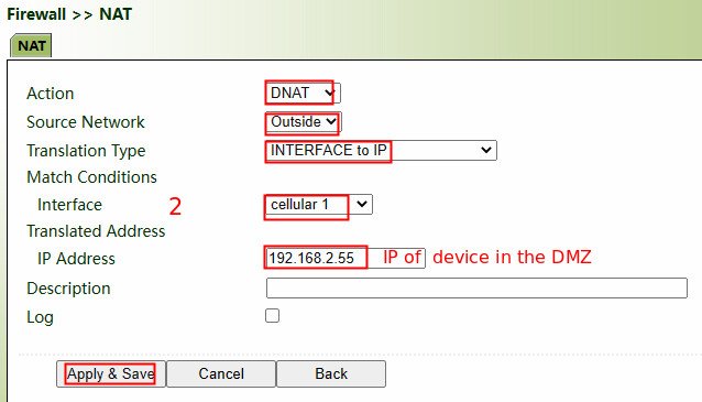

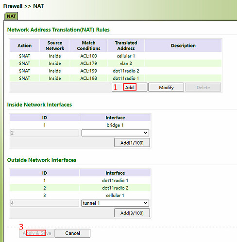

Please try the below pictures to set up DMZ.
666×682 94.8 KB
638×365 52 KB
