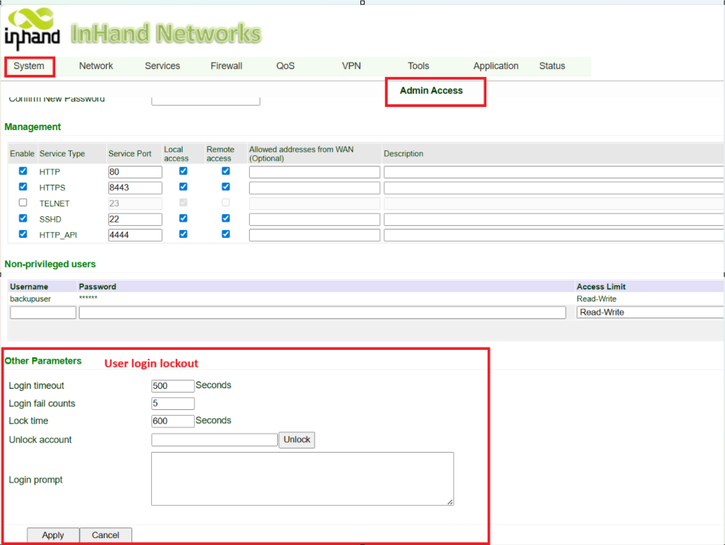

The router temporarily locks a user account after a number of consecutive failed login attempts.
This feature is configured at System=>Admin Access page.
With the above settings, when the account "adm" login fails after 5x attempts, it will be locked for 600 seconds:

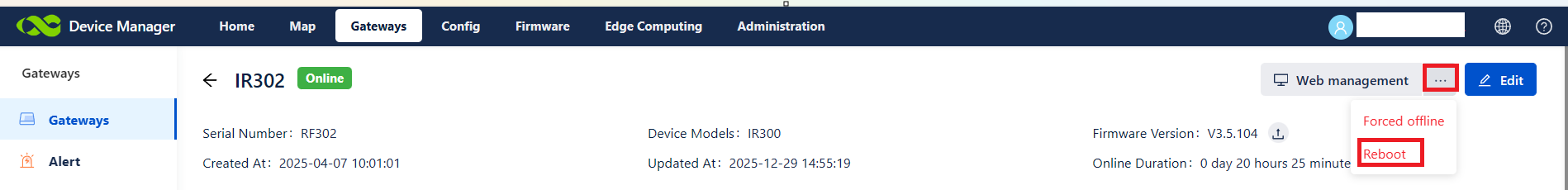

  1. Reboot the device from the Device Manager portal
    You can try rebooting the device from the Device Manager portal. After the device comes back online, log in to the Web GUI immediately before another lockout is triggered.

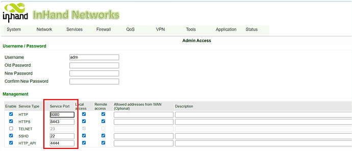

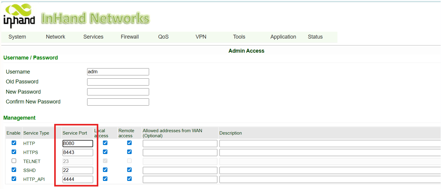

      3. Change the http or https port number
      Using a non-default port can reduce automated scanning and attack attempts.

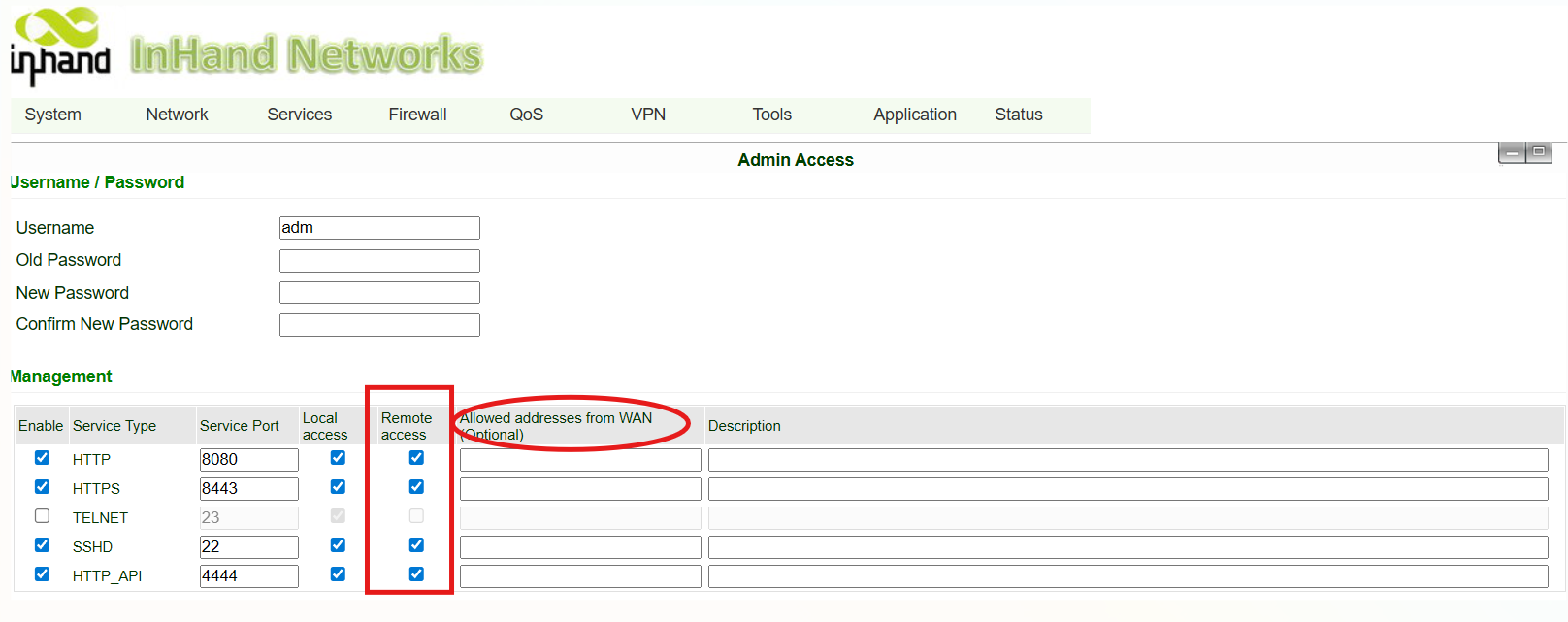

4. Disable or restrict remote access
If remote access from the public Internet is not required, it is recommended to disable Remote access entirely.
If remote access is needed but the source IPs are fixed or known, configure Allowed addresses from WAN (source IP restriction) so that only trusted IP addresses can access the device.
