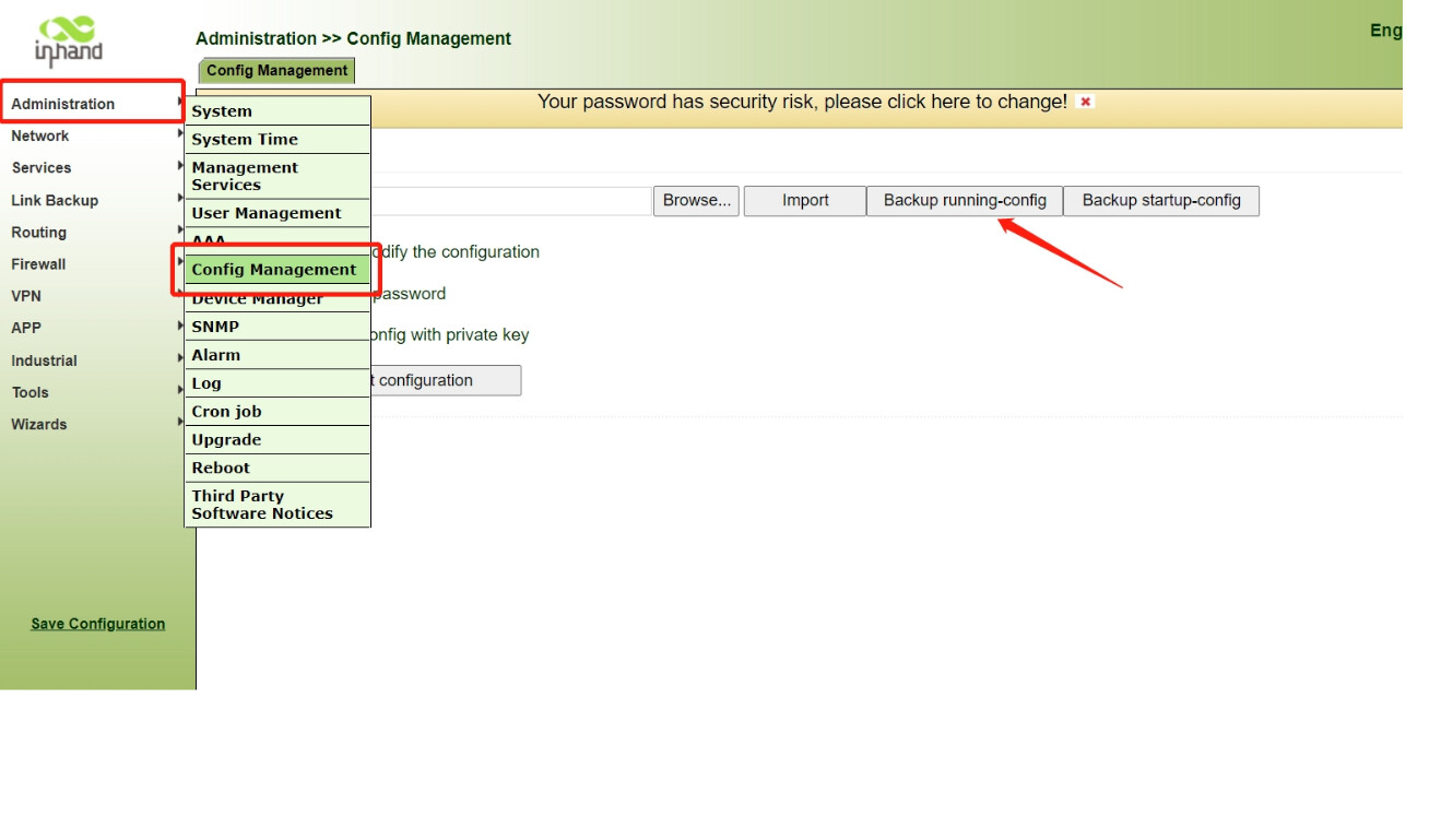

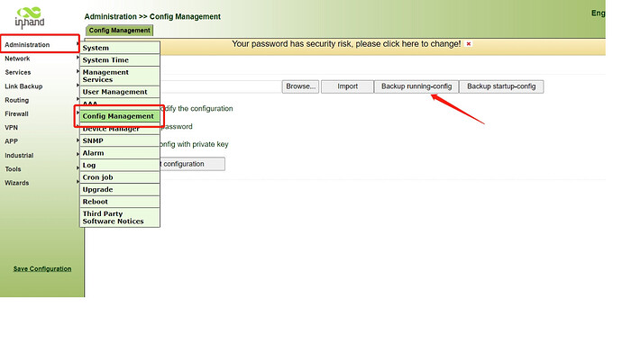

Save running configuration and export it.
Go to Administration >> Config Management, click the
button of Backup running-config, and you will get a backup file, save it to suitable
location.

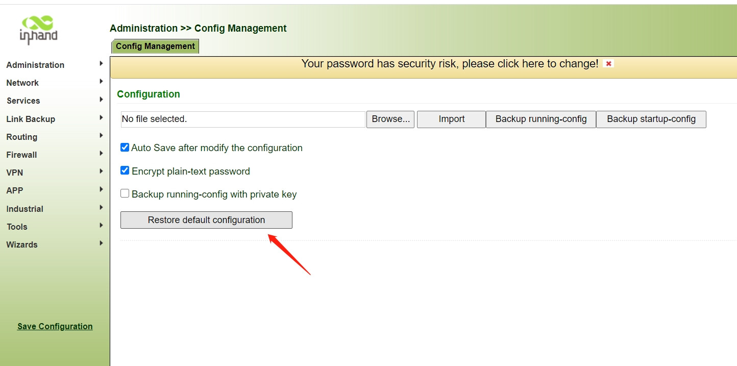

Reset the device
button of Restore default configuration.

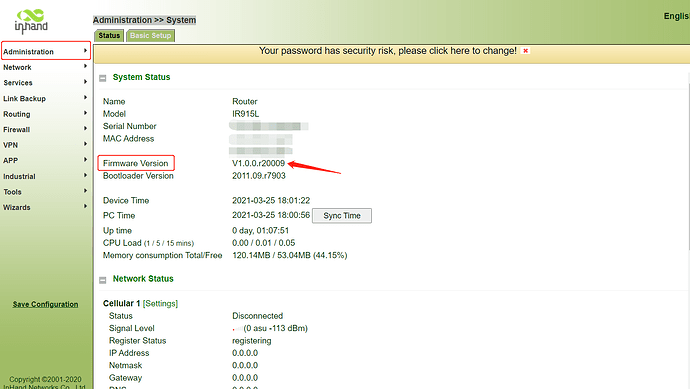

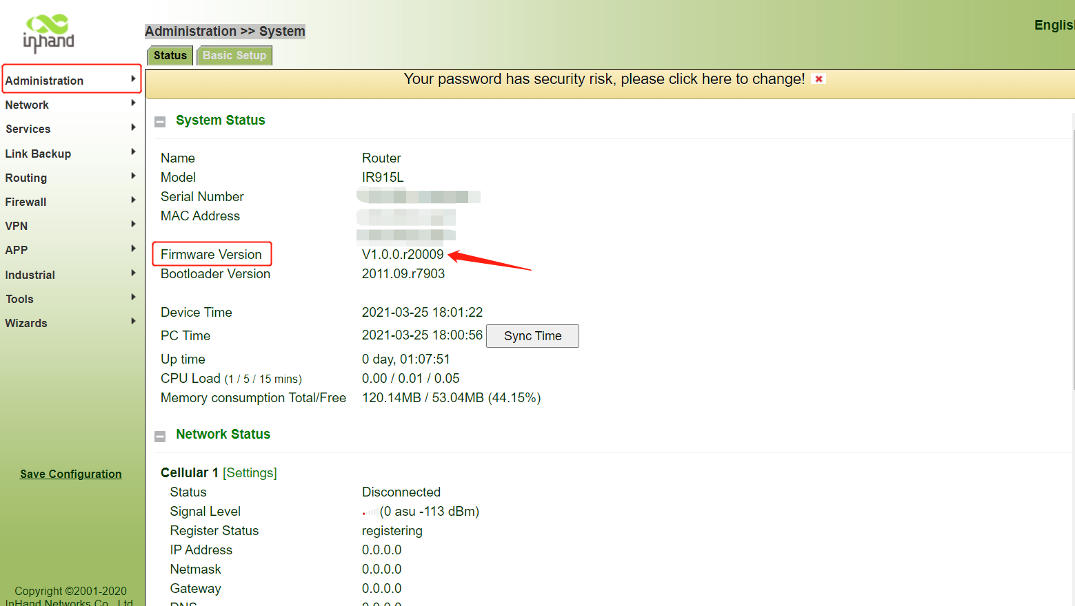

Check IR900 firmware version
Go to Administration >> System to check the current FW version.

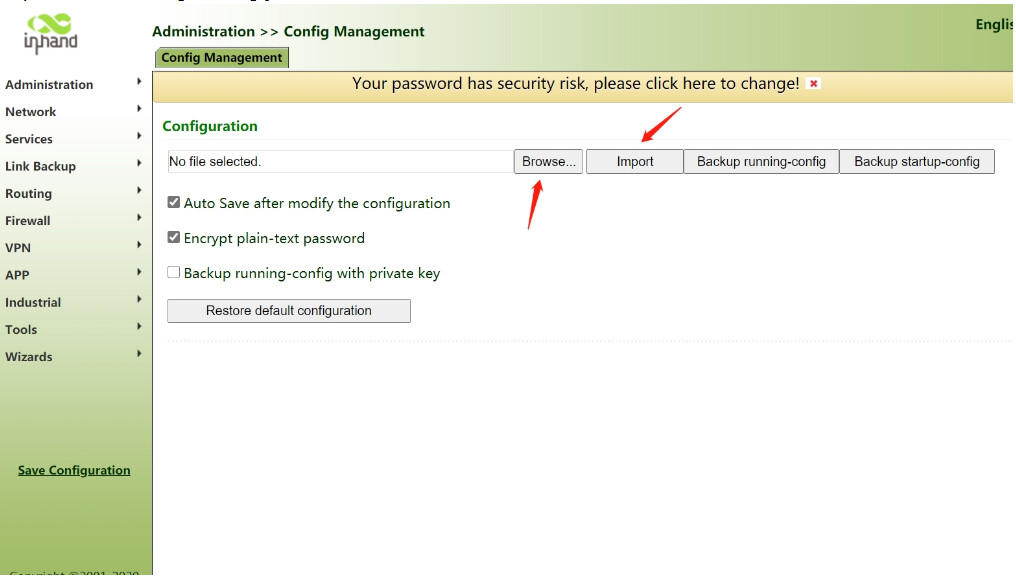

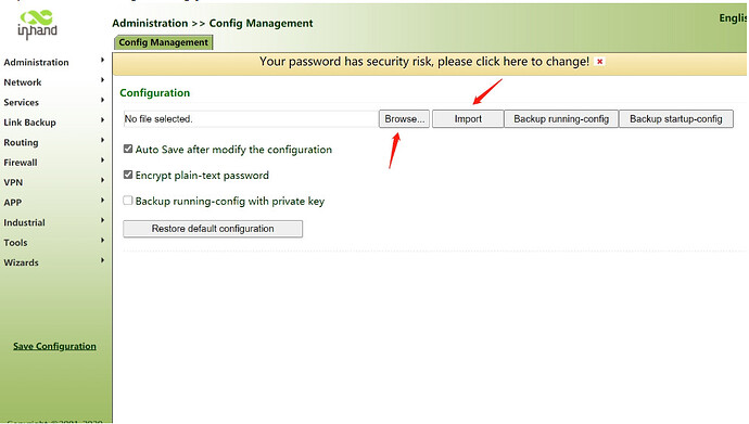

Restore:
Import the running-config just saved
Go to Administration >> Config Management, click Browse to
select the config file just saved, click Import to let the original
configuration take effect:
