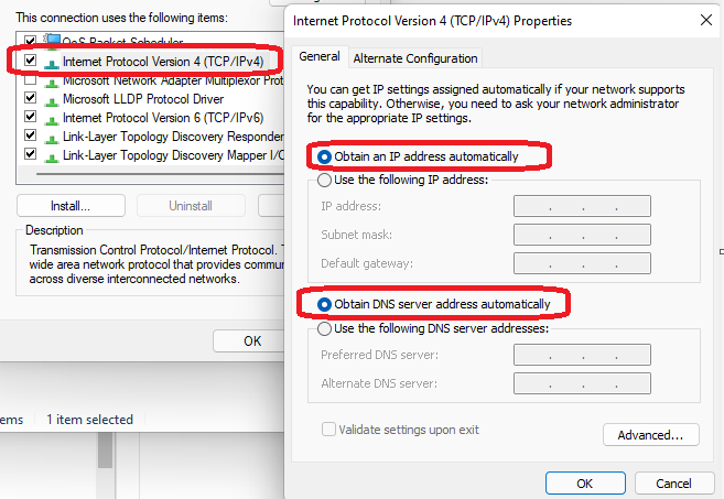

1. On Mac, check in System Preferences>Network>(Name of Ethernet Adapter) to make sure the  adapter is set to "Configure IPv4: Using DHCP". In Windows, it will be in Start>Control Panel>Network Connections (or just search for Network Connections). Rick click Ethernet, select properties. Double click Internet Protocol Version 4 (TCP/IPv4). Set to Obtain an IP address and DNS server address automatically.

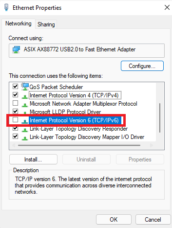

3.  In the same Ethernet Adapter properties in Windows, uncheck Internet Protocol Version 6 (TCP/IPv6), the adapter could be set to IPv6.
