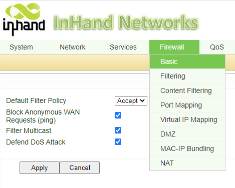

2. Disable Ping
This will prevent your device from responding to or accepting ping requests from the Internet, making it appear like the IP is not being or is offline. Other services like the web interface will still work.
2.1 Log into device via local connection (Default IP is 192.168.2.1) or with static IP address.
2.2 Navigate to Firewall->Basic. Check Block Anonymous WAN Requests (ping) as well as filter multicast and defend DoS Attack, these will help protect user against attacks as well as keep data usage low.
Note: Once ping is disabled, users can't ping it from internet anymore, so please make a note of this for the future when engineers need to troubleshoot.

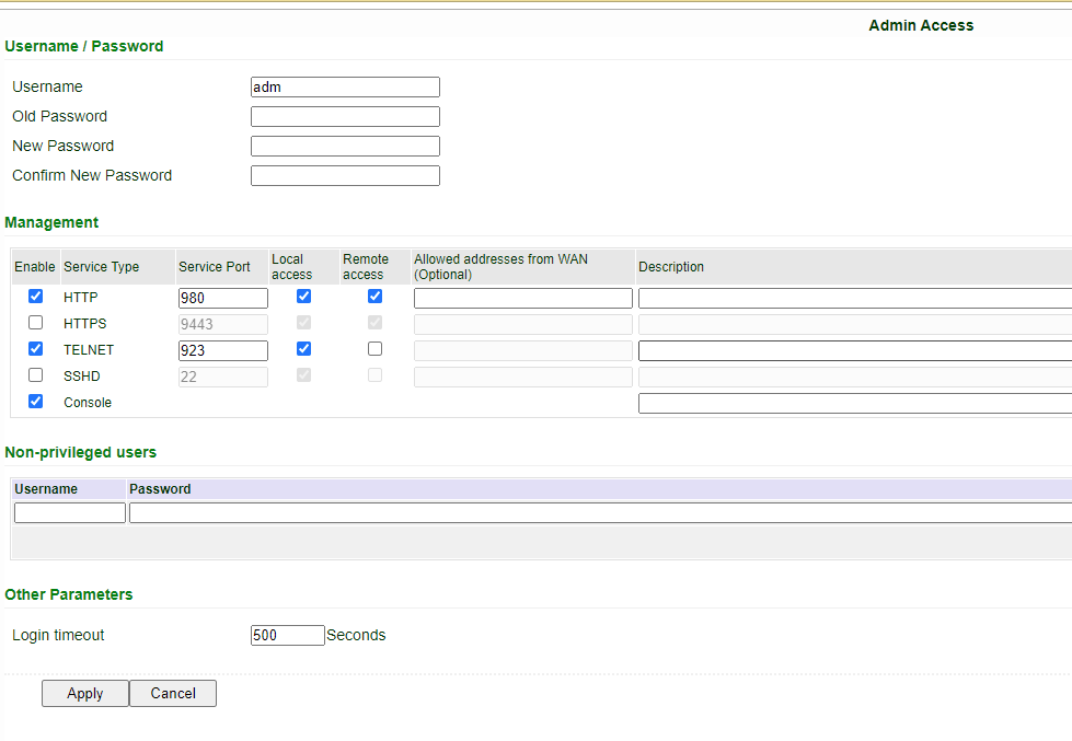

3. Disable Ports
If common ports aren't changed, any traffic on the public static IP that goes to the ports will reach to the router, which will consume data and might slow down the bandwidth. By changing the ports to a less common number, it makes it harder for attackers to guess which port is open.
3.1 Navigate to System->Admin access.
Default HTTP is 80, HTTPS 443, Telnet 23. Change the values of these Service ports or disable the port for Remote Access. Hit apply when done.
Note: Once the Remote Access is unchecked, users may not be able to access it remotely anymore. Please also make a not of any port changes, so if engineers need to access telnet or HTTP, they will know which port to access the router from.

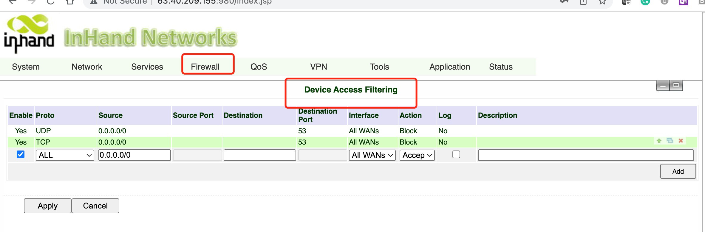

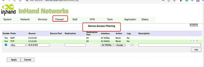

4. Block DNS port requests
The DNS port on InHand Device is port 53, and it cannot be changed. To protect this port, we need to add Firewall filtering to block all incoming request from WAN.
Go to Firewall>>Device Access Filtering, and add following firewall rules.
Hello, Is it still necessary to manually create firewall rules to block DNS access from WAN, or has this been built-in to the latest firmware? I can't see any reason why access to the device's DNS server/service would ever be allowed from a WAN connection (this certainly should be blocked by default!).
