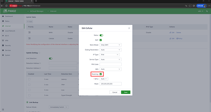

If you have a FWA02-EUNR, traveling from France to Spain, and already enable the roaming for SIM card with ISP. However, the FWA02 still doesn't work.
The method for sloving the issue:

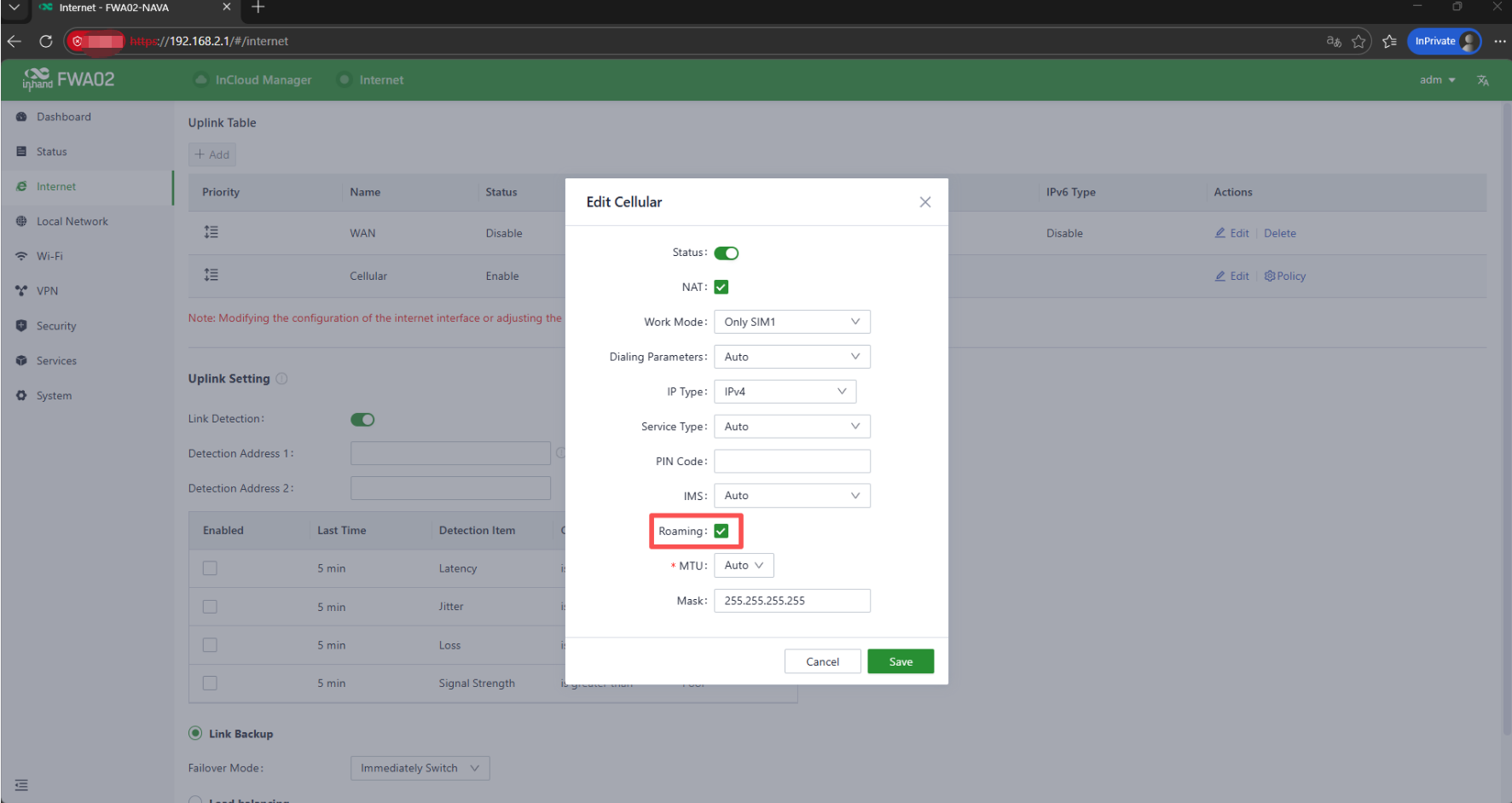

Please log in the FWA02, edit the Celular,  then enable the Roaming function.
