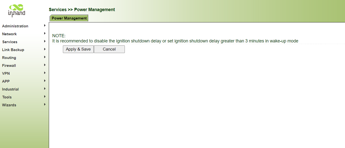

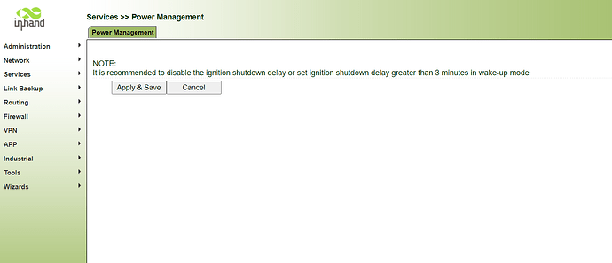

Could you kindly provide a solution on how to fix the power management section not having any options like in the screen shot? I am running a VG710 with firmware: V1.2.1.r30052

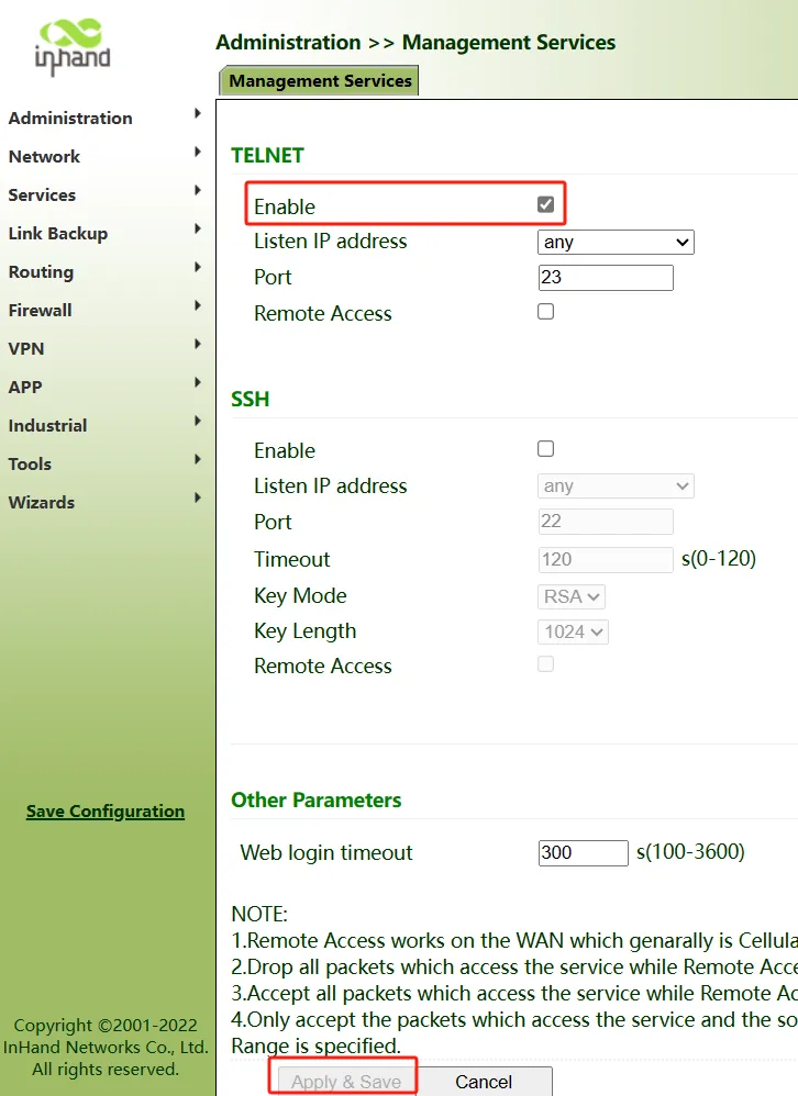

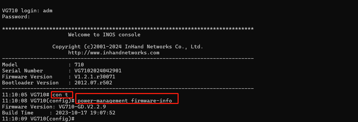

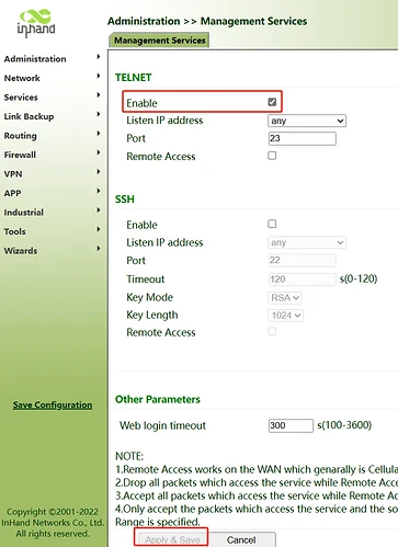

1.Access the device's web interface, click on "Administration" > "Management Services", enable Telnet service, and access the device through Telnet.
2.Execute the following command.

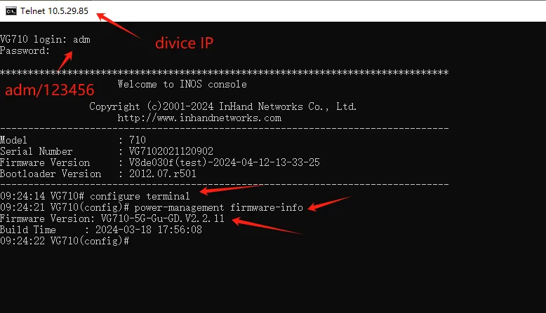

Hello, please use telnet to log in to the device and check the power management firmware version.
