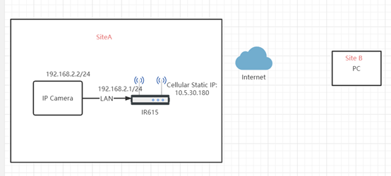

As the following show, any device which is capable of reaching internet can access the IP
camera on site A (192.168.2.2:80) via port mapping (10.5.30.180:8001).
Here we configure the testing IR615 at site A.

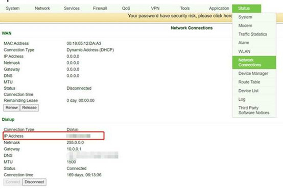

After login to the Web UI, you can navigate to Status->Network Connections to check the
static IP of the device. The cellular Static IP of our testing IR615 is 10.5.30.180.

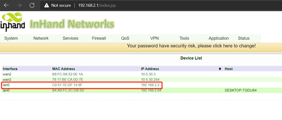

Then you can navigate to Status->Device List to check the connected devices and their
assigned IP addresses. The IP of our testing camera is 192.168.2.2.

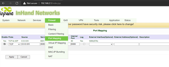

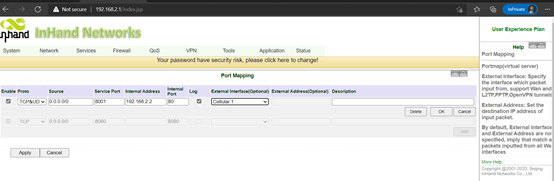

Firewall-> Port Mapping
Source IP: 0.0.0.0/0 (allow any IP from the external port-Cellular 1)
Service port: the service ports opened on the router.
Internal Address: IP addresses of the lower end devices.
Internal ports: service port of the lower end devices.

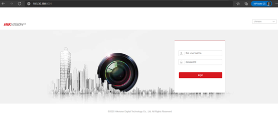

For example, here is when any external address accesses port 8001 of 10.5.30.180 (assume
it is dial-up assignment), it actually accesses port 80 of 192.168.2.2 (lower side IP camera).
The PC at site B can enter 10.5.30.180:8001 to access the IP camara on site A.
