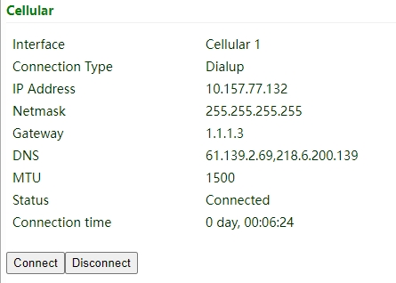

let me explain to you how the DNS service works on our router.
Normally, the router will get the DNS server address for your Carrier, and it's the priority.
Check on Status->Network Connection.

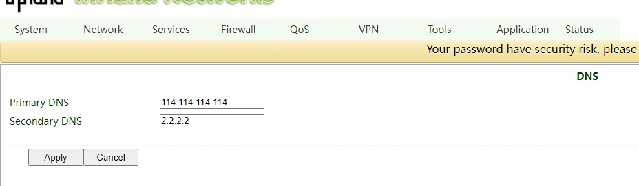

If you add the DNS server manually, Services->DNS

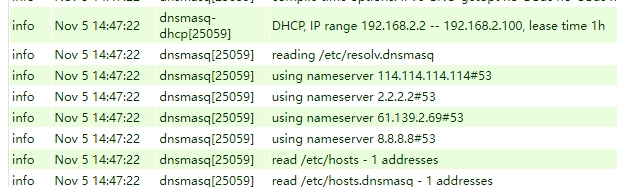

Check on Status->log, the priority becomes the ones you just configure.
and you may notice the last one 8.8.8.8, it's the Google DNS server written in our router in case all above are expired.
