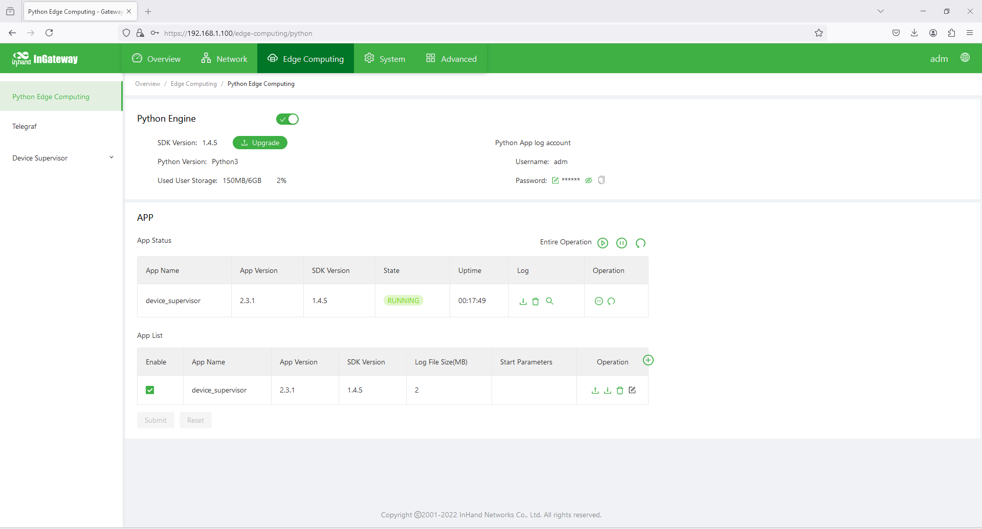

Not have enable debug mode

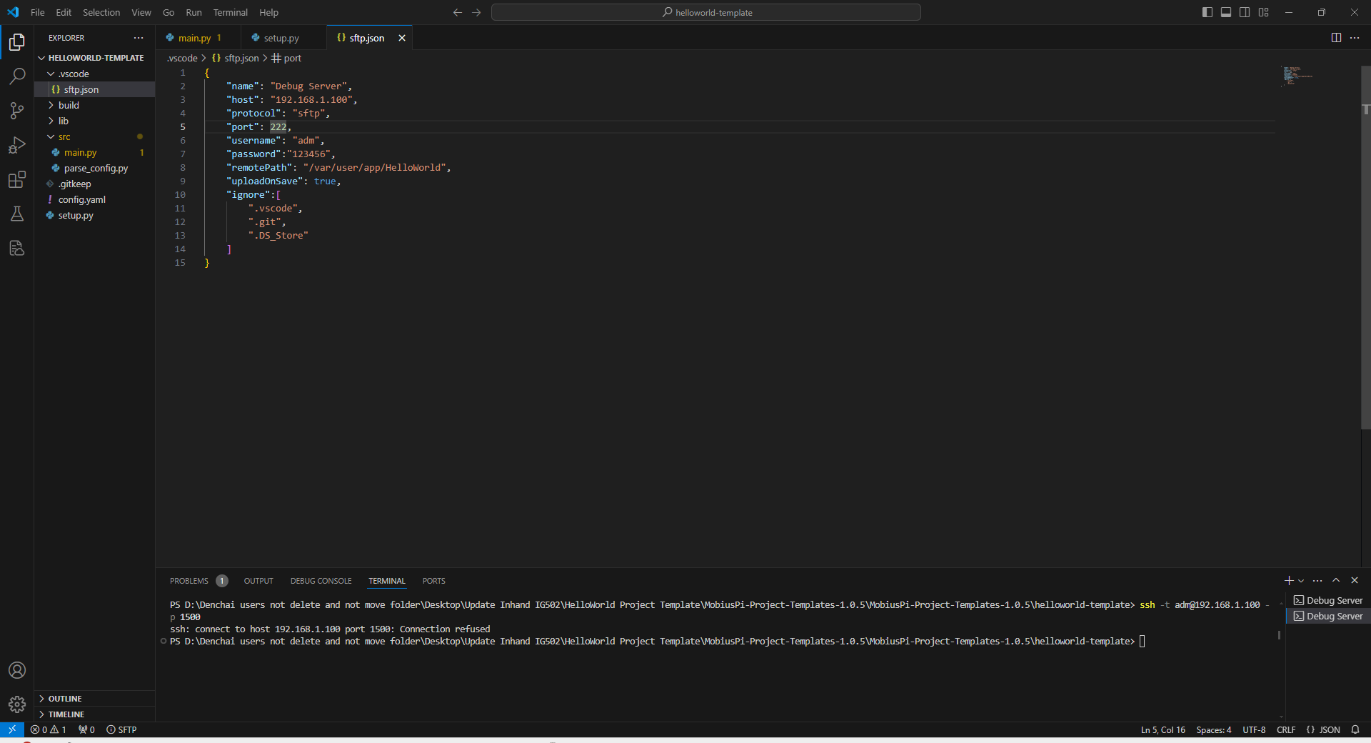

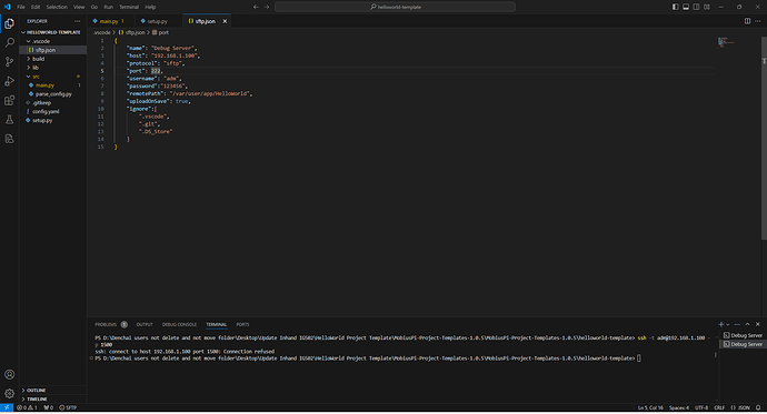

I want to test https://sdk.ig.inhandnetworks.com/en/latest/MobiusPi-Python-QuickStart-EN.html#prepare-the-hardware-and-network-environment but python cannot connect like this picture

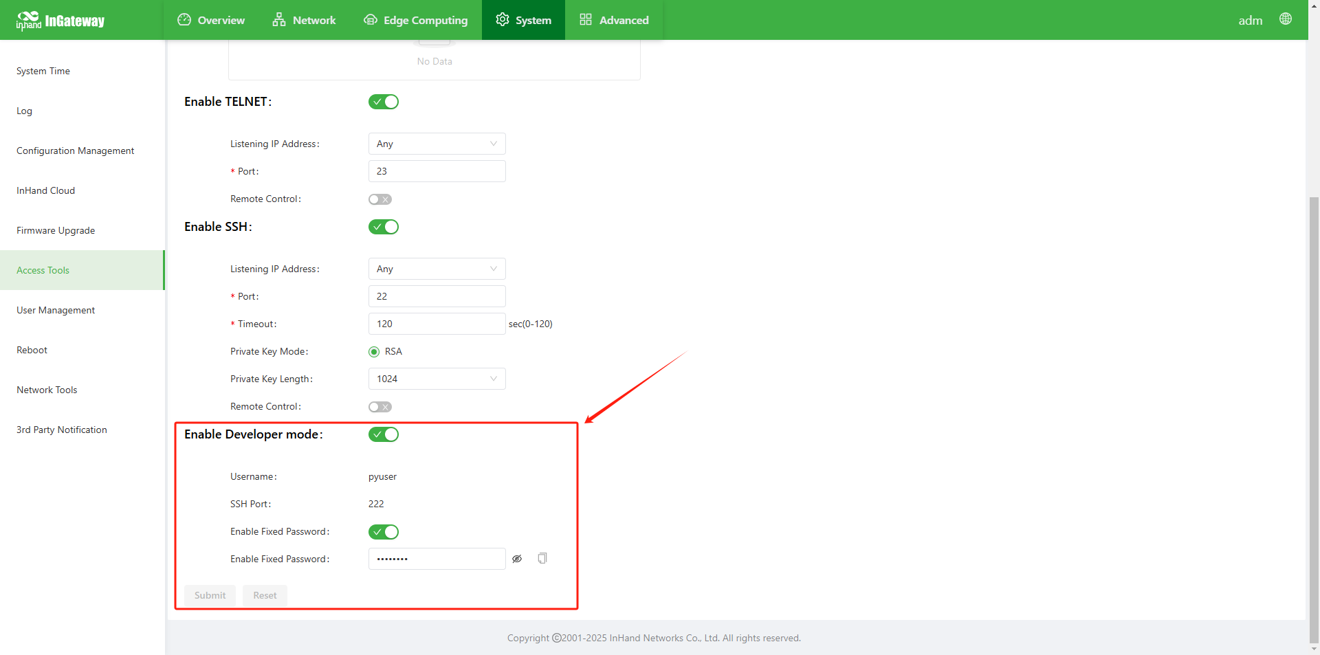

Maybe the enable debug mode are gone as picture below and i cannot setting
What should i do , how to make python work?
You should enable the pyuser user here!
