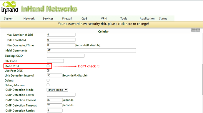

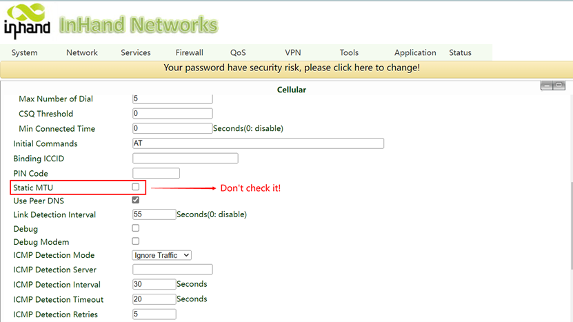

3. The setting on our device
For different carriers, MTU is not standard. For most ethernet devices, it is 1500, but for Verizon they only accept 1428. Too large or too small MTU will lead to the problems. On our device we have two options, static or dynamic MTU. We recommend to always use dynamic, which means the router will ask the carrier for their MTU size and change it.
4. How to set MTU on Inhand devices?
Go to NetworkàCellular, check the Show advanced options, scroll down to MTU, and confirm uncheck the static MTU.

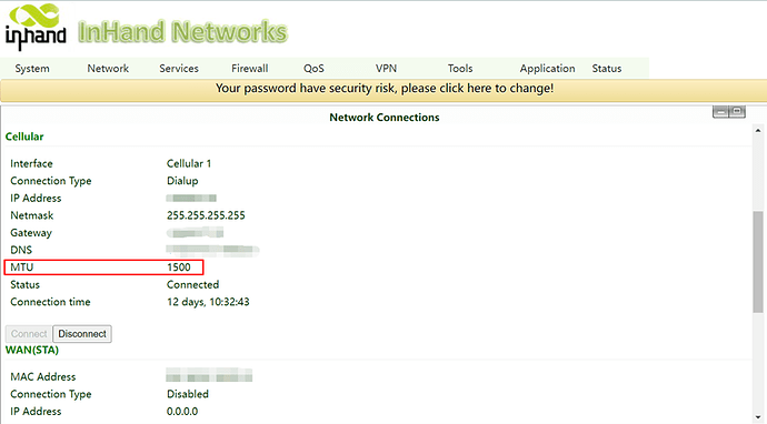

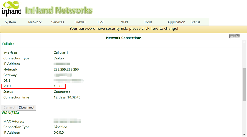

And you could check MTU of your device via
StatusàNetwork
Connections.
