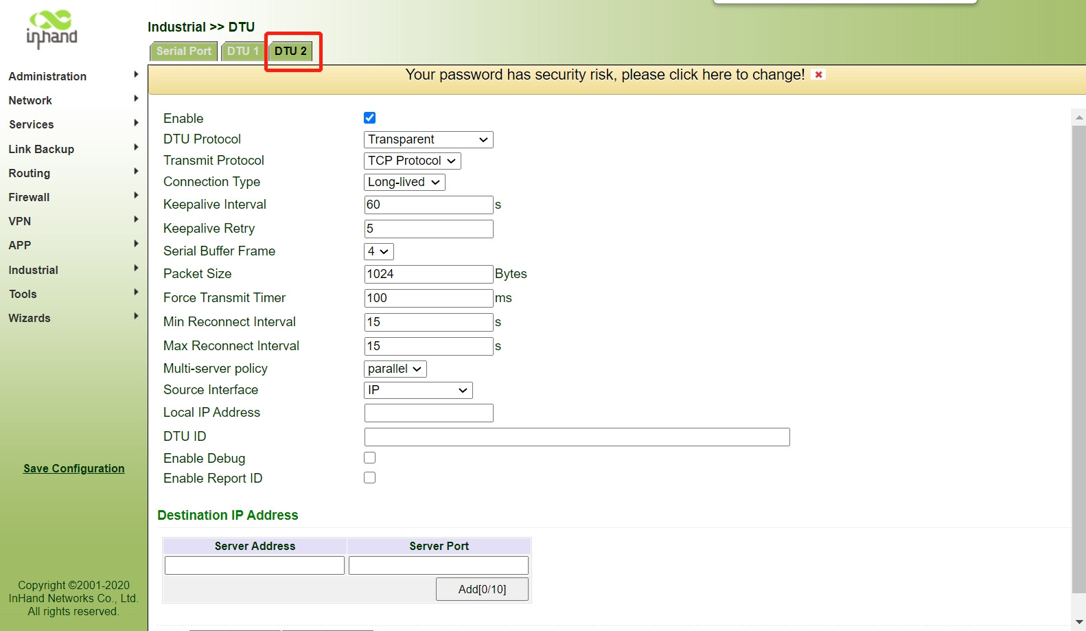

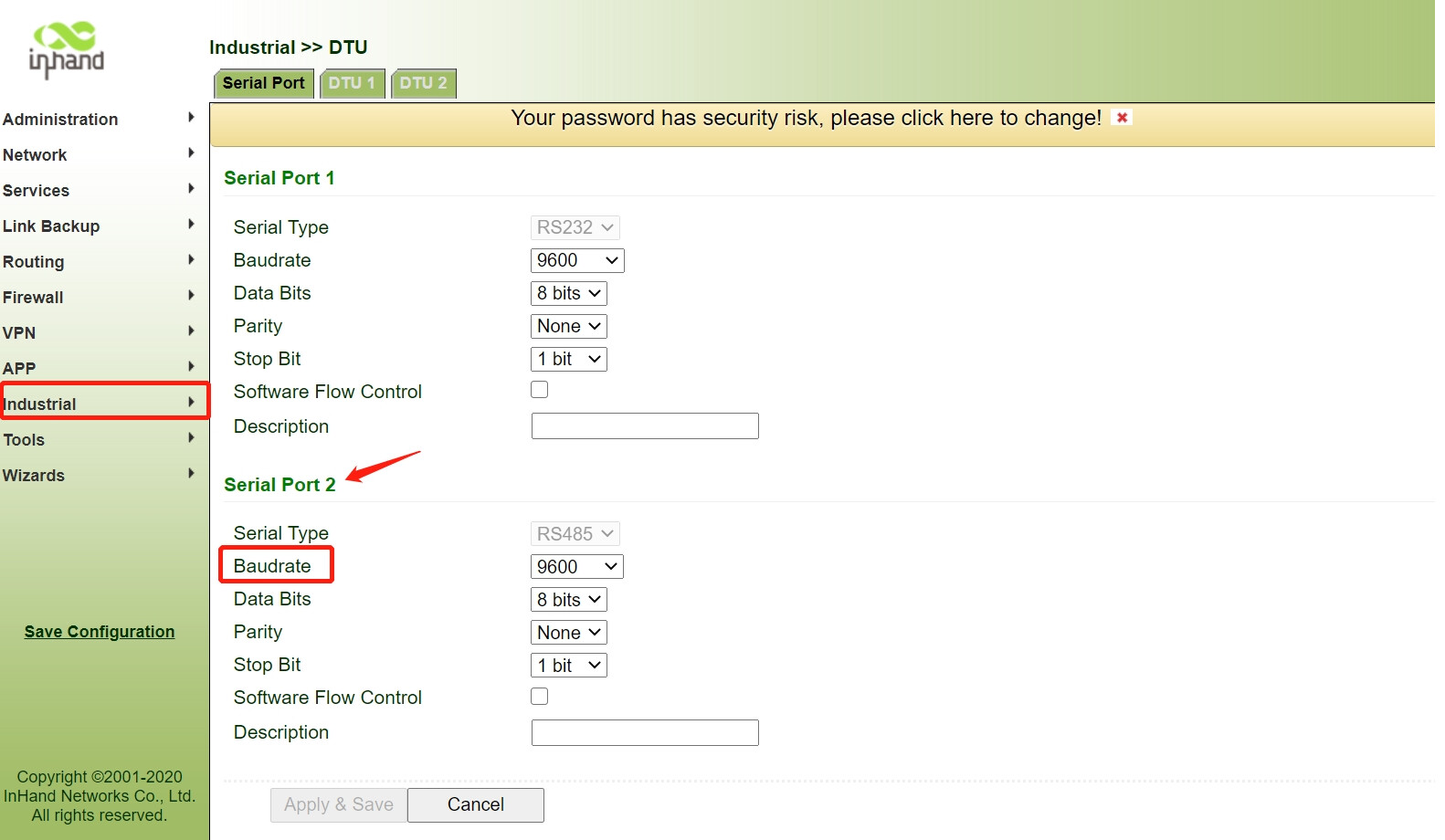

Hi, I don't get see modbus device through TCP , Do you have a guide?
I'm going to use only a PC -Router- Modbus device, I used TCP server configuration and the conecction is ok but I don't see modbus device.
If I conecct serial modbus ditectly to the PC I can conecct without problems.
BR
Dear Sebastian:
As we talked about the problem in the email, I suggest you visit the router web configuration page again and refer to the manual from page 50 to page 51 to check whether the configuration parameters are set correctly.
and you replied to me that you have upgraded IR915 to the latest firmware, after the operation, the bridge option has appeared, please let me know if the problem have been solved by yourself.
Thank U.
