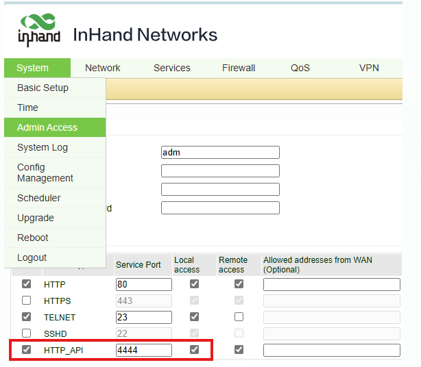

Dear Customer,
It's possible to get IO status by HTTP_API. The default port is 4444. Please check if this port has been enabled at System=Admin Access:
Then you can send the below commands to get the status of IO:
curl -u adm:123456 192.168.2.1:4444/iodigital.cgi -d "type=get&io=1"
io_level=high
SUCCESS
curl -u adm:123456 192.168.2.1:4444/iodigital.cgi -d "type=get&io=2"
io_level=low
SUCCESS
