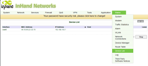

  3. Navigate to Status -> Device List to see what devices are connected to your router currently, as shown below, the write down the MAC addresses of those two unauthorized devices.

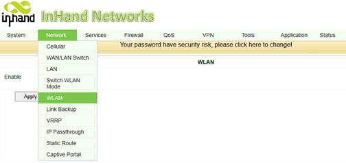

  1. Blacklist or whitelist the devices by navigating to Network -> WLAN interface as below, then check Enable box.

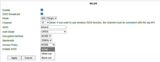

  2. Then you will see the interface like this:
  3. Change Access Policy from None to White List or Black List as your preference:

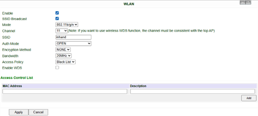

  4. Then after entering the MAC address of one unauthorized device, click Add button at the bottom right corner. Repeat to add more devices.
    After all devices added, click Apply button to apply the changes. The new rule will be in effect immediately.
* Important note
This method uses Blacklist to block the access of the unauthorized devices. If Whitelist is preferred, please add the authorized devices MAC addresses only.
