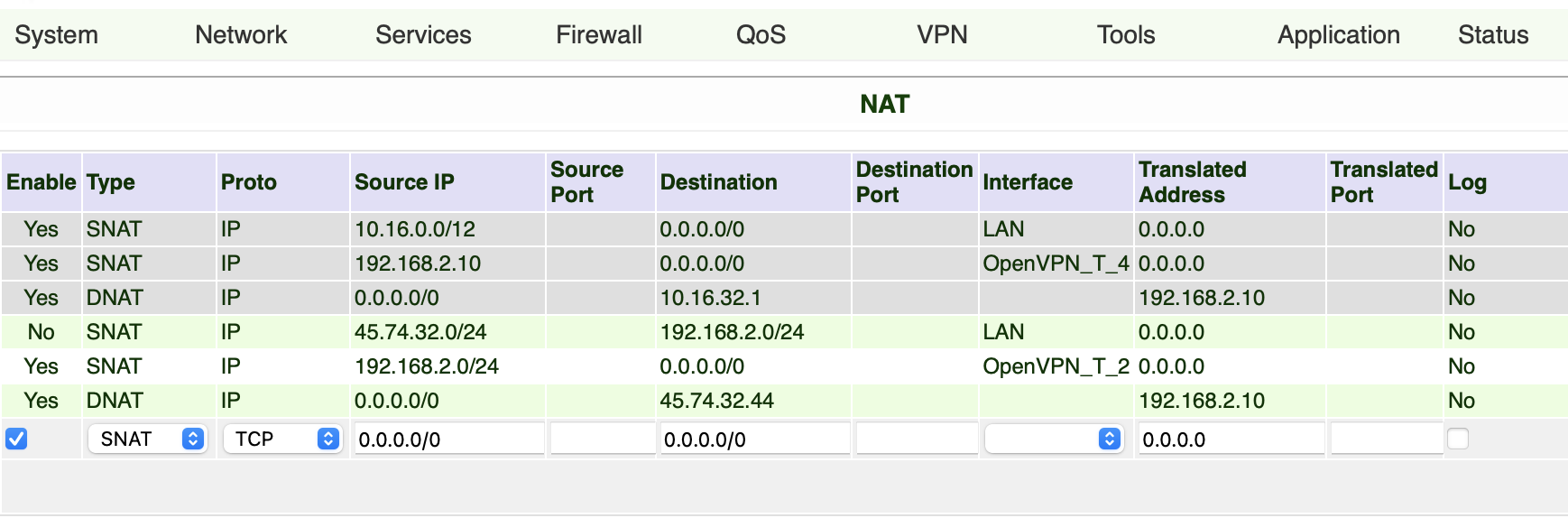

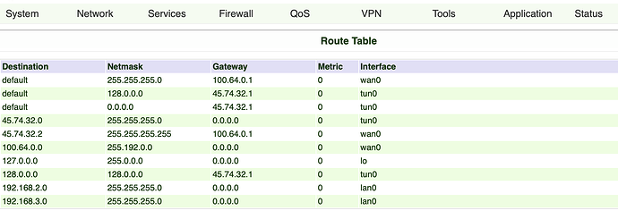

I have setup an IR302 Router with a VPN service. I am able to use the VPN IP address for the system and connect to a modbus device that is plugged into the LAN port. However the VPN is not as fast as my ISP. I have been trying to figure out the right way to direct my internal ip through the VPN tunnel and have the wifi users bypass that tunnel. Is it even possible.
192.168.2.10 -> lan port to use the vpn (this can be changed to whatever if required. Currently assigned as static IP via the Mac address.)
I have DHCP enable and setup to enable 192.168.2.2 -192.168.2.254.
I was thinking of trying to limit the DHCP range to exclude the static .10 address but not sure if that is the right way to approach this. I have recently changed the SNAT source IP from being 192.168.2.10 as I found that I could not access the Internet from the wifi connection and now I can.
Would it be better to open the subnet up so I can have a DHCP range of 192.168.3.0 and then configure NAT to somehow only use the wan interface? I did try to relate this to the article
