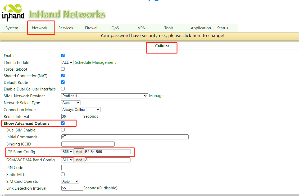

The new version supports this feature
Firmware download:https://www.inhand.com/en/resources-center/#/IndustrialDigitalization/InRouter/IR302
Hello, this feature is already supported in V3.5.60 and later.
