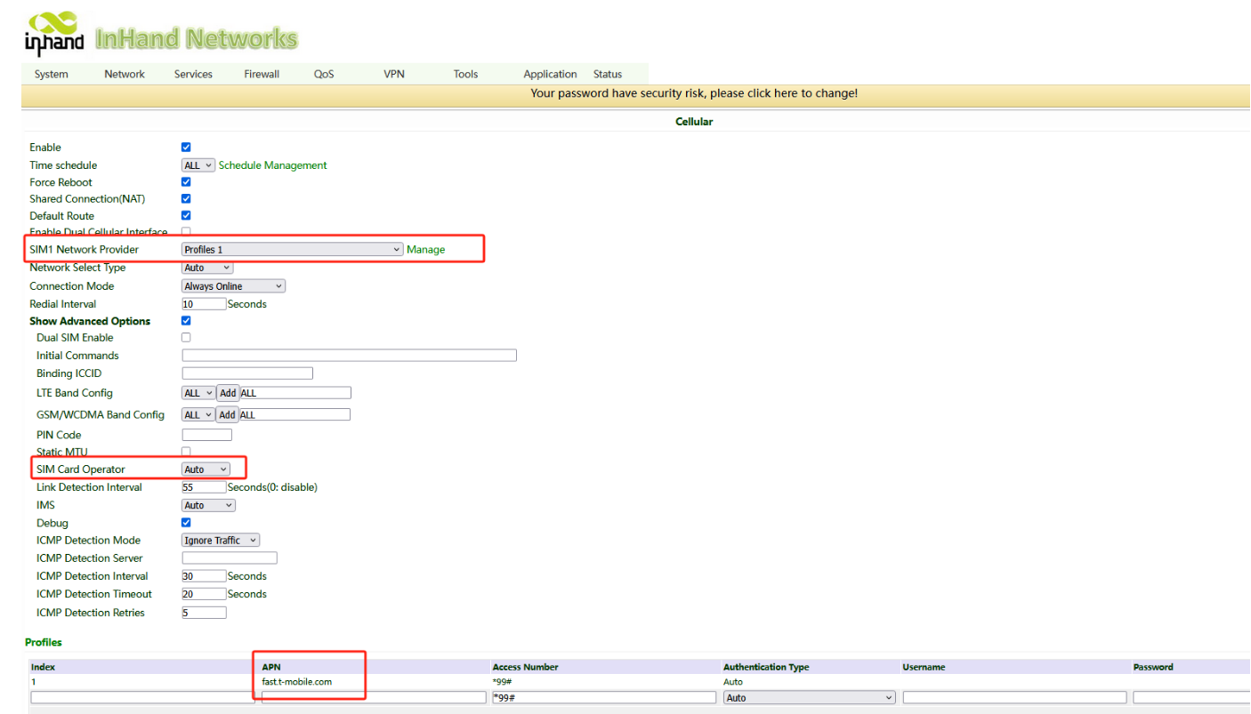

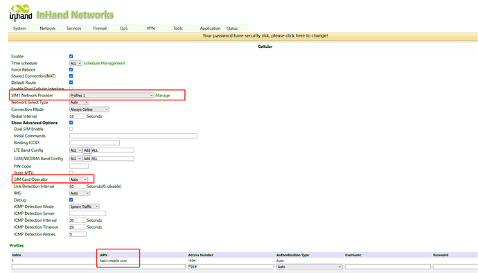

From the device log information, it was discovered that the device is using a T-Mobile SIM card with the APN fast.t-mobile.com; however, the device is currently configured for the VERIZON carrier, resulting in an incorrect APN configuration and causing network anomalies.
Please check whether the configuration is incorrect and refer to the following correct settings:
