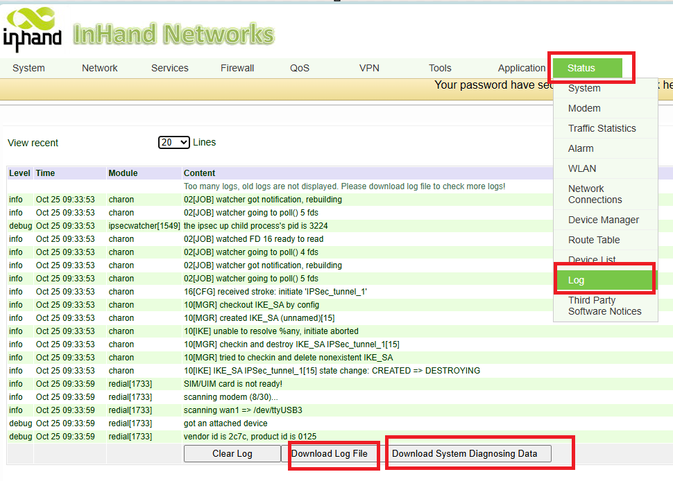

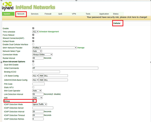

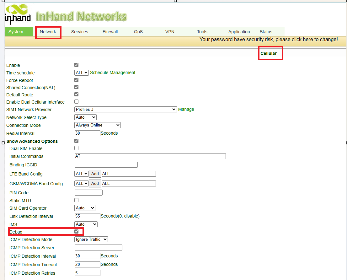

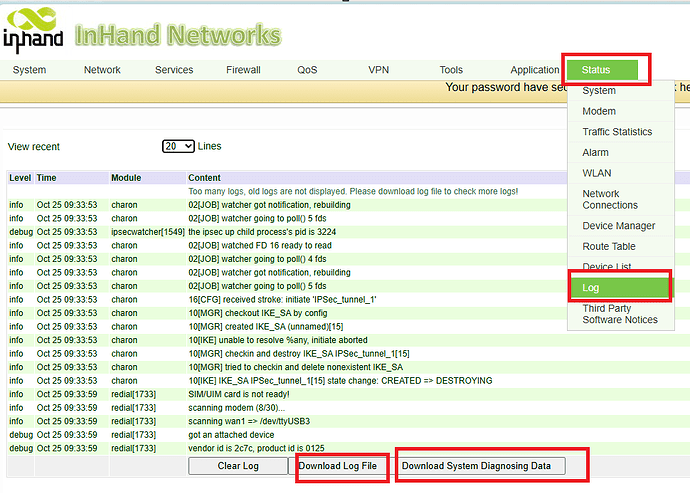

It would be helpful if you could provide some logs with us.
Please log in the management page and go to Network=>Cellular, enable Debug:
Then go to Status=>Log, click Download Log File and Download System Diagnosing Data:

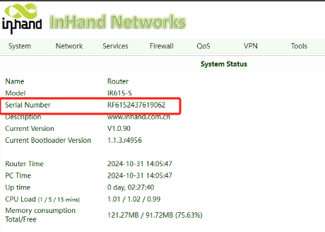

the serial number you provided, RF302245388768, is missing a digit. Could you please take a picture of the serial number on the device or capture a screenshot from the front-end interface?
For your reference, here’s an example of how the serial number should appear on the front-end interface:
Thank you for your assistance!
