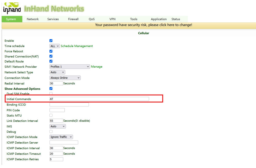

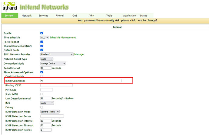

At present, the locked frequency band can only be filled in through AT initialization command
Format: AT+QCFG="band",<bandval>,<Itebandval>
<bandval>: Configure GSM/WCDMA frequency bands.
0: Do not change the existing configuration.
<Itebandval>: Configure LTE frequency band (the parameter name you provided may be incorrect, presumably LTE band).
for example:
AT+QCFG="band",0,1 Band1
AT+QCFG="band",0,4 Band3
AT+QCFG="band",0,10 Band5
AT+QCFG="band",0,80 Band8
AT+QCFG="band",0,8000000 Band28
AT+QCFG="band",0,8000000000 Band40
AT+QCFG="band",0,10000000000 Band41
