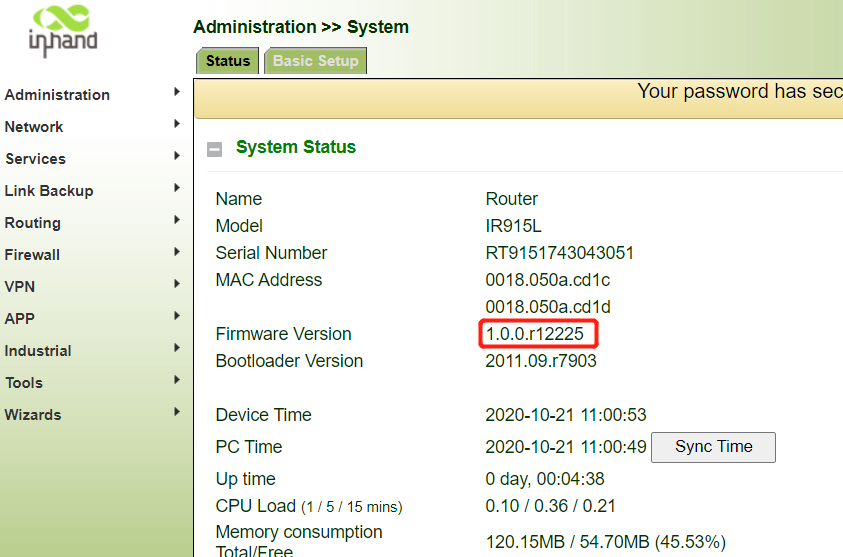

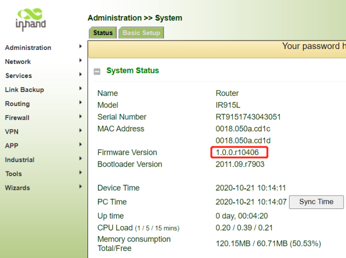

1. check your current f/w version. Go to Adminiatration->System

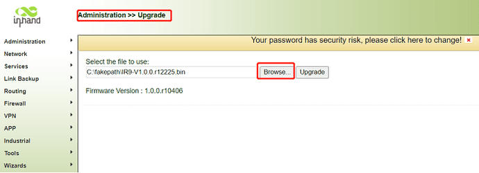

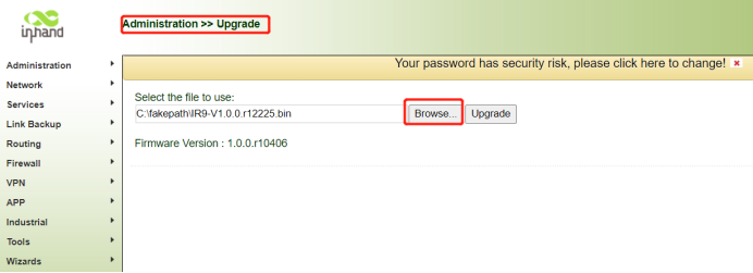

3. upload the f/w.
4. upgrade.

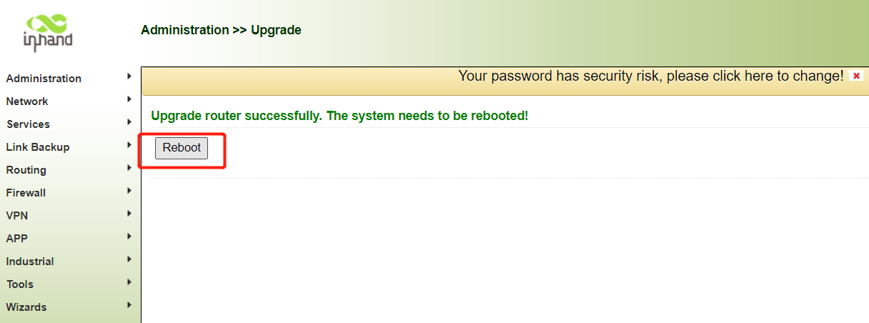

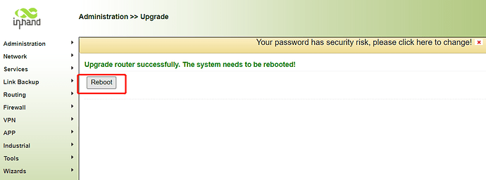

5. reboot.
