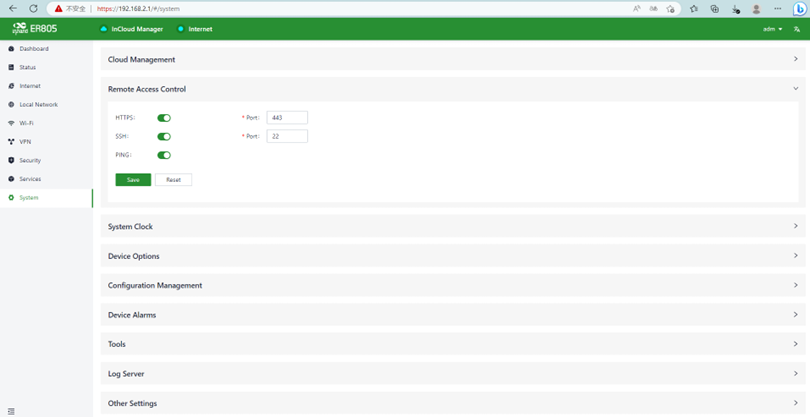

1.    Log in ER, and go to SystemàRemote Access Control, then enable SSH.

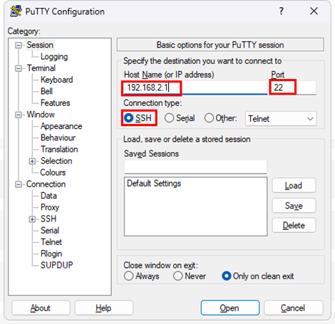

2.    Open Putty, enter the LAN ip address of ER, fill in the ssh port(default value is 22), choose the SSH for Connection type. Then open it.

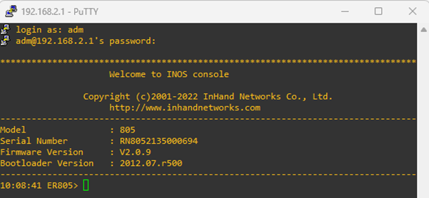

3.    Enter the username and password of ER805, then you could log in ER805.
