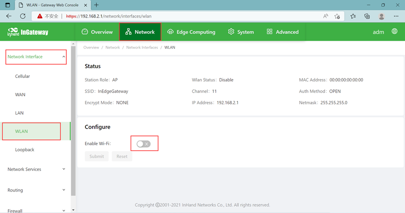

2. Go to NetworkàNetwork InterfaceàWLAN, and Enable Wi-Fi.

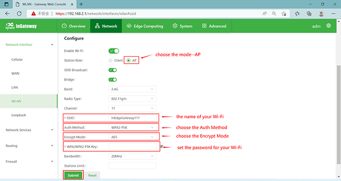

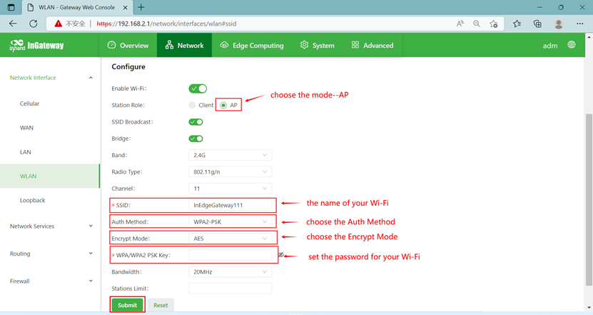

3. Turn the Station Role to AP. Set the SSID which is the name of Wi-Fi network; Change Auth Method to WPA2-PSK. Change Encryption Mode to AES. Change WPA/WPA2 PSK Key to what you want the password to be (8 character minimum). Hit Submit.

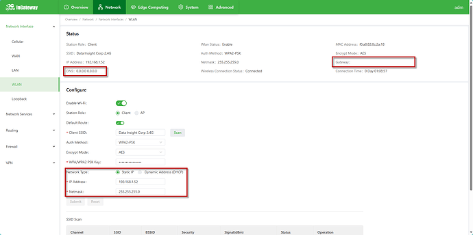

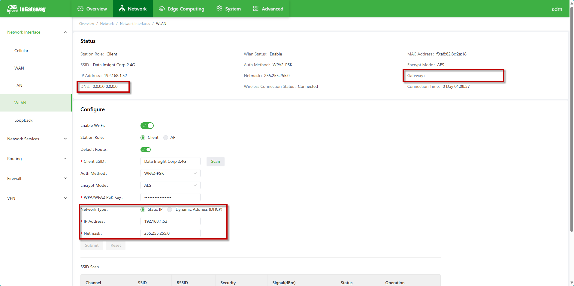

I am setting WLAN in IG502. I want to set a static IP, 192.168.1.52, but IG502 can't connect to the Internet ( no DNS from the router and no Gateway Info).
How can I adjust this IP?
