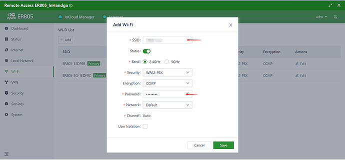

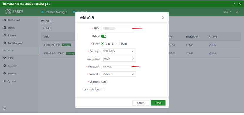

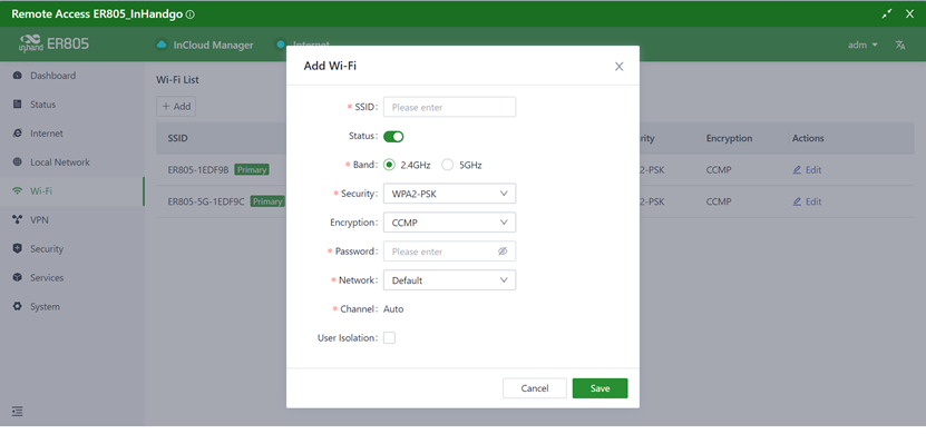

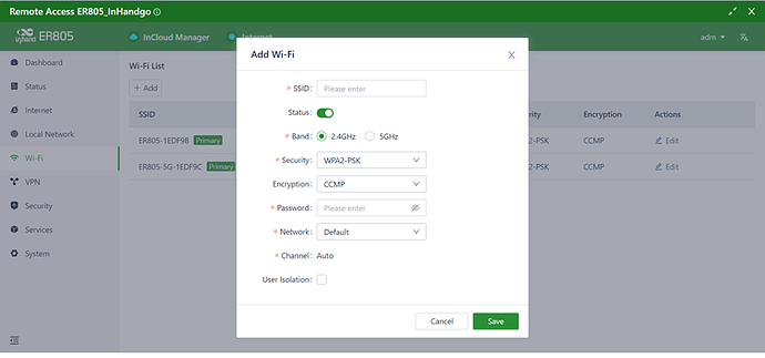

2. Click the "Add" button to add a new SSID.
3. Set SSID and Password, other Settings are changed as needed.

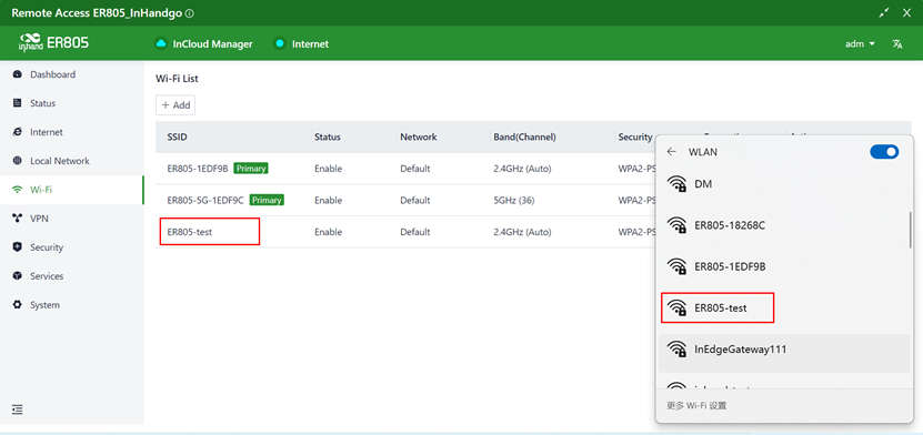

4. View the result.
