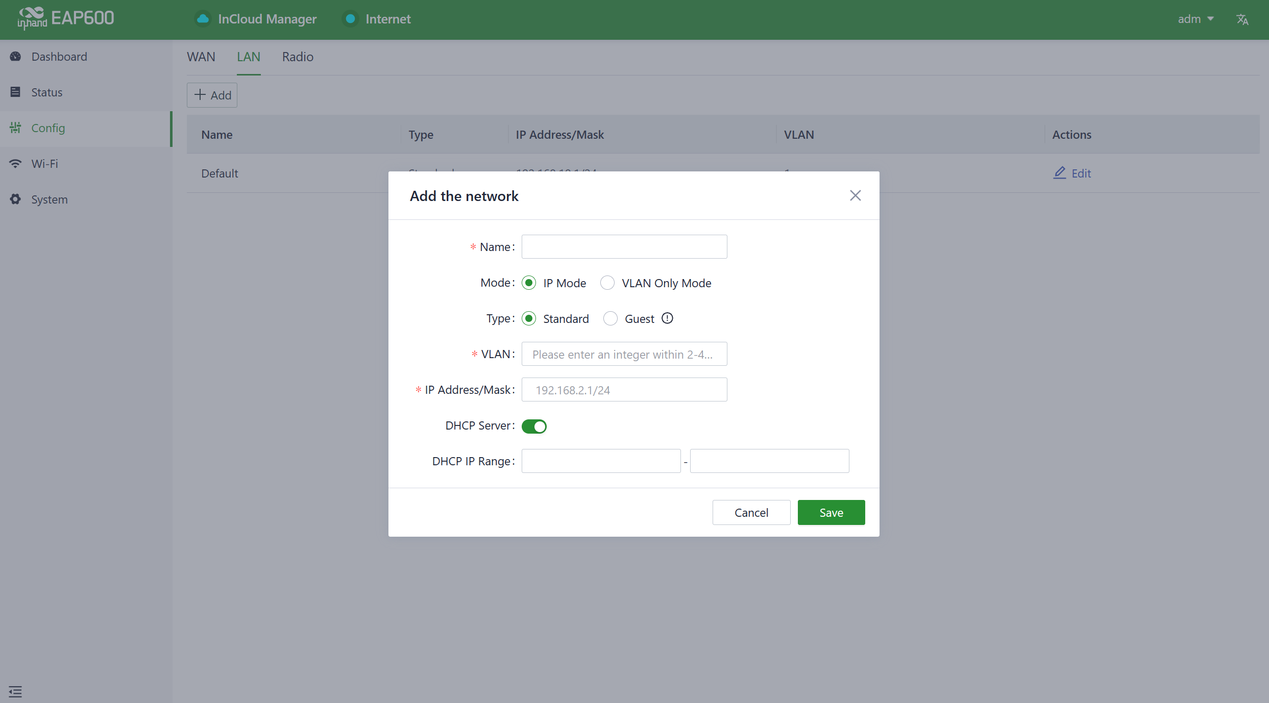

How to set up guest network for EAP600 wireless AP?
Go to config-LAN, you can configure the local LAN subnet
The "Network Type" field provides two available modes:
  1. Standard: Clients connected to the standard mode network can access the Internet and the device's web interface.
  2. Guest: Clients connected to the guest mode network can only access the Internet and cannot log in to the device's web interface.
  3. Edit Local Network: You can adjust the parameters of an existing local network, and the configuration fields are the same as when creating a new network.
