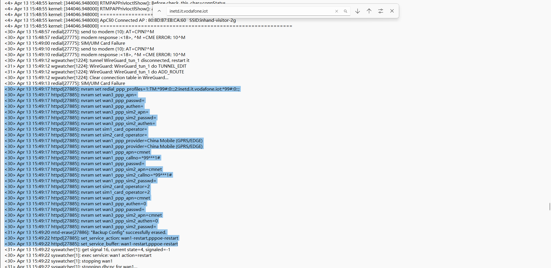

  2. Set your expected parameters on web manually and save. Then download the log file, you will find something like below, all the httpd-related parameters and value need to be recorded. (Note that there are some service action and service buffer)

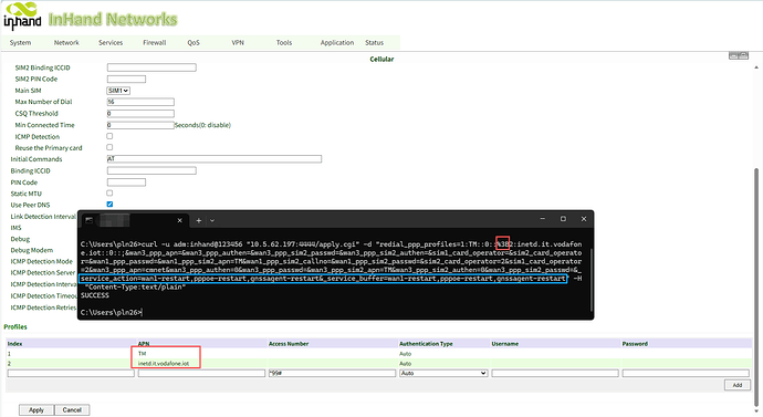

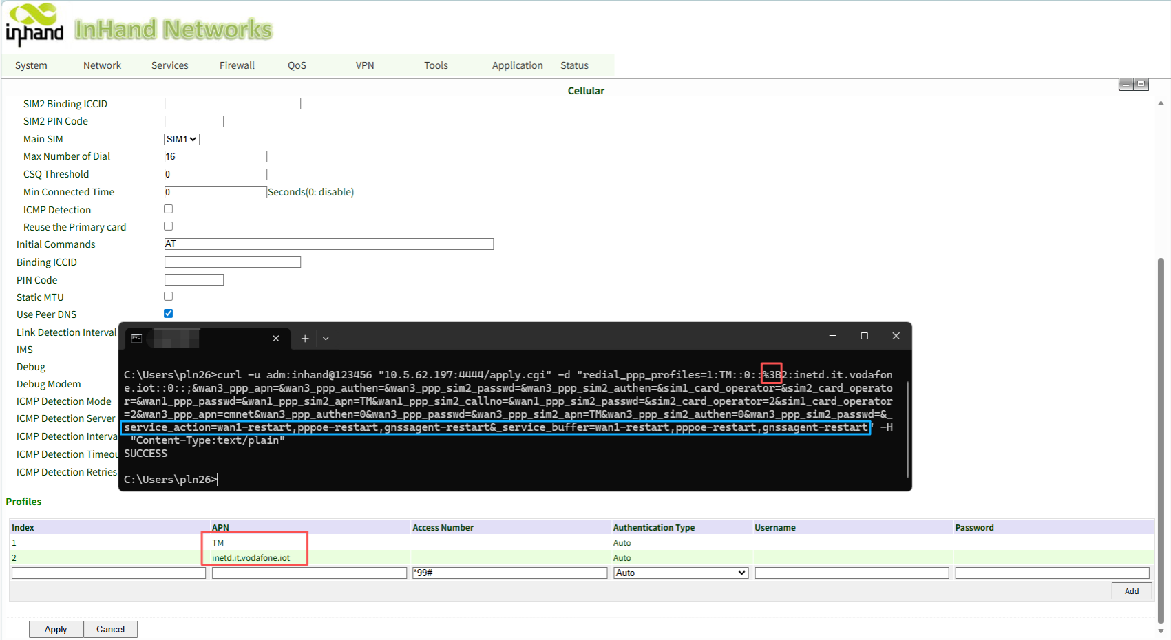

  4. Then you could init a HTTP API command with all above parameters and value. Please just replace the only one ; between the two profiles, others can keep there. Don't forget the services. You could see my test is successful.
  5. The command I use is:
    curl -u adm:inhand@123456 "10.5.62.197:4444/apply.cgi" -d "redial_ppp_profiles=1:TM::0::%3B2:inetd.it.vodafone.iot::0::;&wan3_ppp_apn=&wan3_ppp_authen=&wan3_ppp_sim2_passwd=&wan3_ppp_sim2_authen=&sim1_card_operator=&sim2_card_operator=&wan1_ppp_passwd=&wan1_ppp_sim2_apn=TM&wan1_ppp_sim2_callno=&wan1_ppp_sim2_passwd=&sim2_card_operator=2&sim1_card_operator=2&wan3_ppp_apn=cmnet&wan3_ppp_authen=0&wan3_ppp_passwd=&wan3_ppp_sim2_apn=TM&wan3_ppp_sim2_authen=0&wan3_ppp_sim2_passwd=&_service_action=wan1-restart,pppoe-restart,gnssagent-restart&_service_buffer=wan1-restart,pppoe-restart,gnssagent-restart" -H "Content-Type:text/plain"
