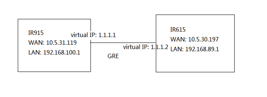

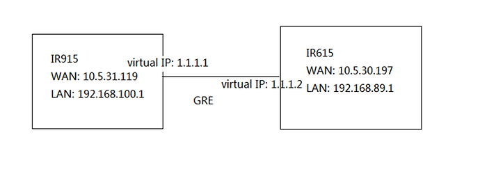

How to set GRE VPN between IR615 and IR915?
Industrial Routers
February 27, 2026, 9:01am
865×314 29.6 KB

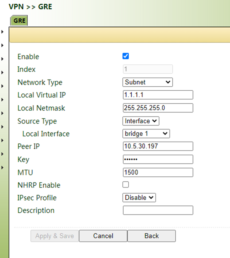

In IR915:
742×831 106 KB

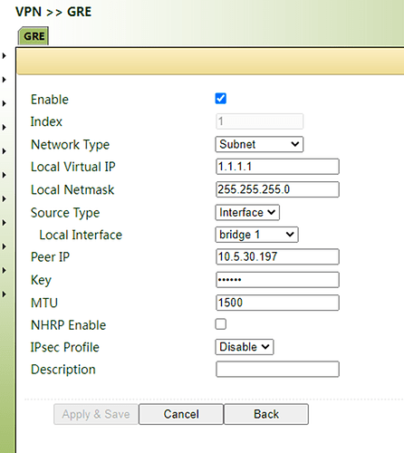

IR615:

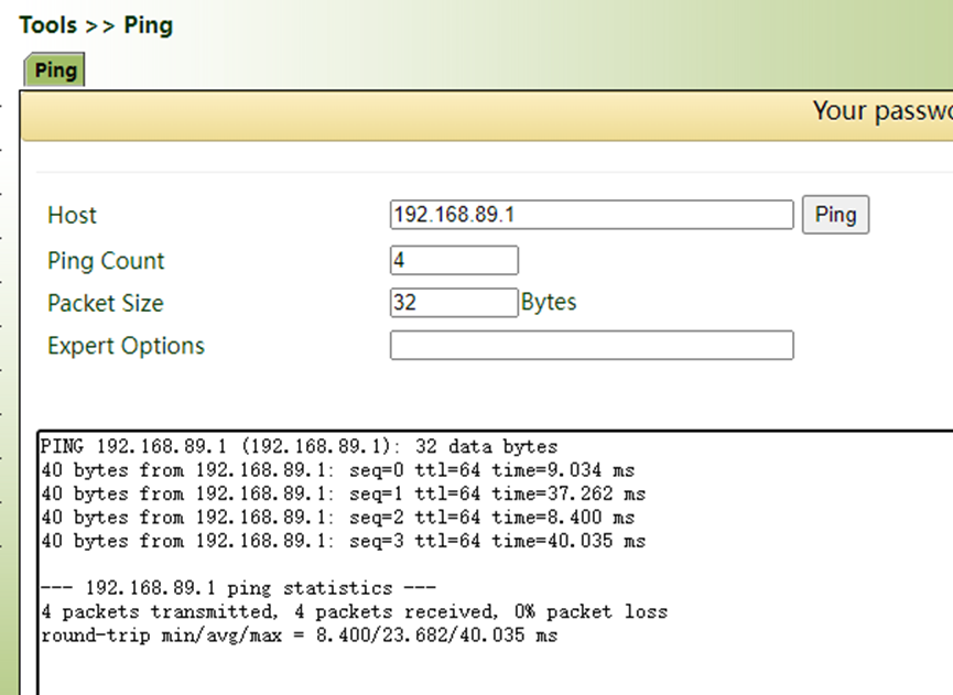

After configure GRE, IR915 can ping to
IR615’s virtual ip

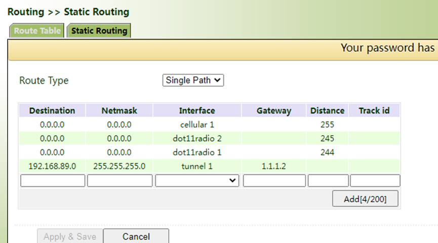

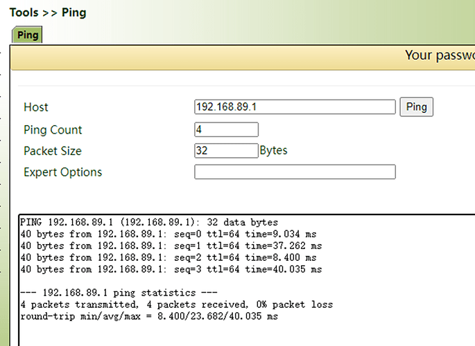

Add static route in IR915
865×480 95.8 KB

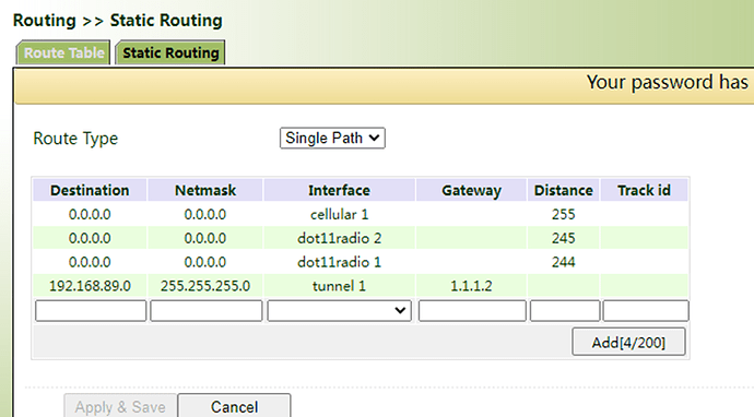

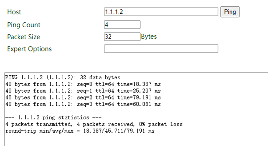

Ping to IR615’s LAN
865×631 92.6 KB
