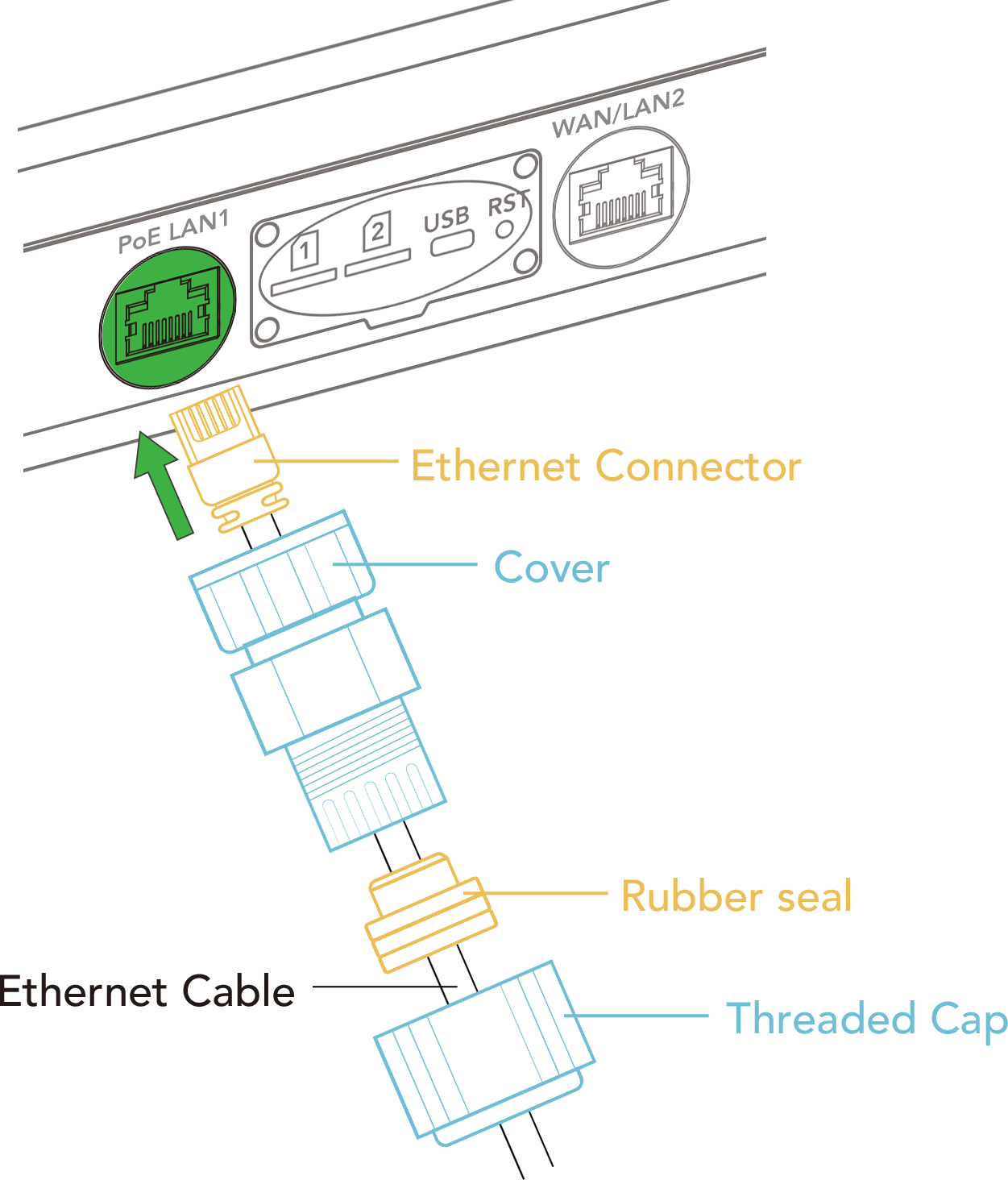

  5. Cut the Ethernet cable to the appropriate length according to the distance from the ODU to the power supply and pass it through the bracket.

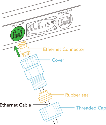

  6. Use the ethernet cable after the crystal head is processed and pass through the waterproof PG head in the order shown in the figure below.
  7. Schematic diagram of patch cable passing through the waterproof head
  8. Insert the Ethernet cable into the network port of the device, and tighten the waterproof head in the order of B, C, D, and E to complete the installation.

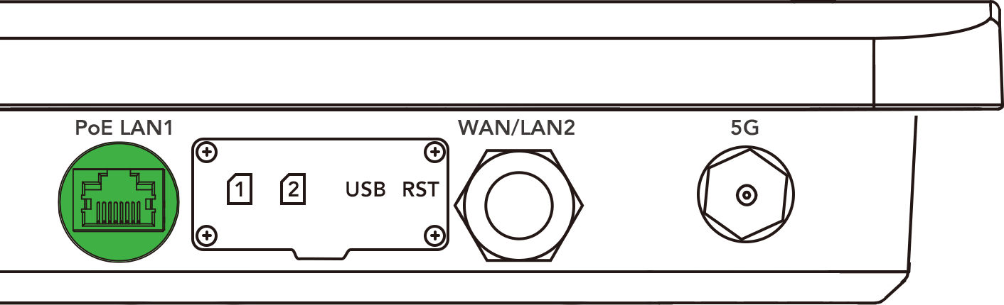

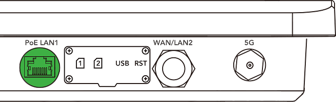

Connect PoE Power Adapter
Connect one end of the Ethernet cable to the PoE 2.5G LAN1 port and plug the other end into the 802.af(50V/0.3A) PoE Adapter or an router/switch with 802.3af port.
