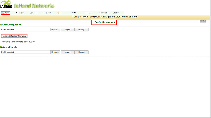

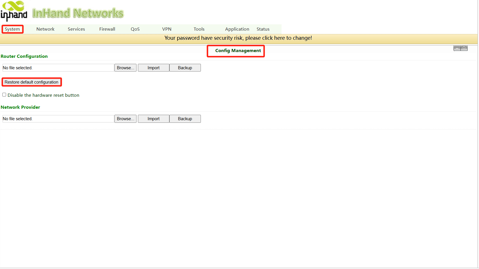

There are two ways to perform the factory reset on IR302:
- Software way: Navigate to the System-->Config Management, Click the Restore default configuration
