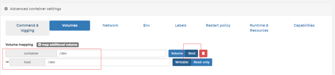

When deploying the container, add Volume Mapping to the Advanced Container Settings > Volumes page of the Portainer. The following figure maps the files in the dev directory of IG902 to the dev directory in the container (The corresponding interface file is included in the dev directory of IG902).
Enable Privileged mode on the Advanced Container Settings > Runtime & Resouces page of the Portainer (if it is not enabled, using the serial port will prompt that there is no operation authority).

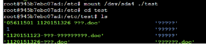

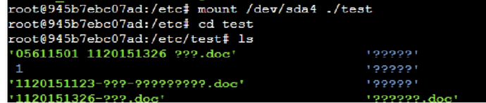

usb flash memory will be shown in /dev, and please use mount command to mount it into container. (in this example, usb driver name is sda4)
