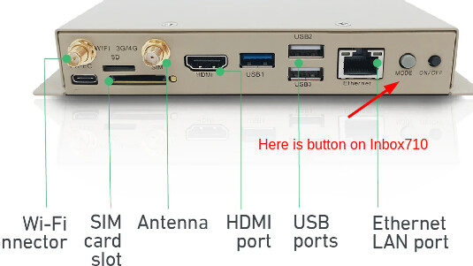

I'm writing android application on Inbox710. and don't know how to listen mode button.
what i want is when i click mode button i want to change application setting and turn back to previous navigation.
