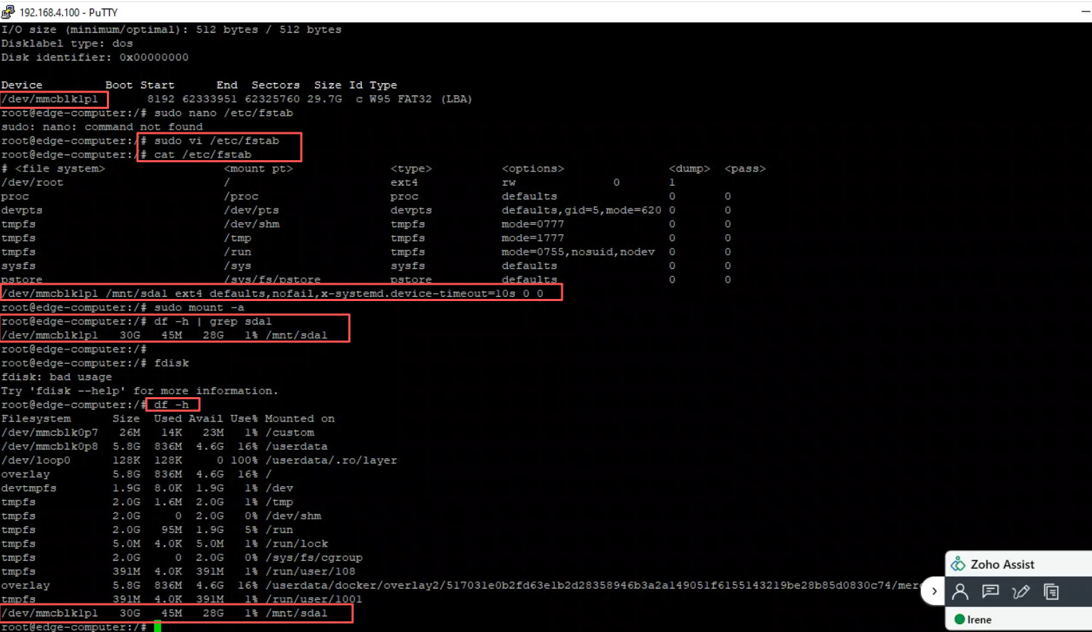

How to format an SD card to EXT4 format on EC?
1. Execute `sudo fdisk -l`, the result is `/dev/mmcblk1p1`.
2. Execute `sudo mkfs.ext4 /dev/mmcblk1p1`.
3. Create the mount point `/mnt/sda1`.
4. Edit the `/etc/fstab` file using `vi`, adding the following line to the end: `/dev/mmcblk1p1 /mnt/sda1 ext4 defaults,nofail,x-systemd.device-timeout=10s 0 0`
5. Use `cat /etc/fstab` to check if the addition was successful.
