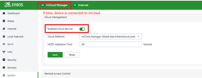

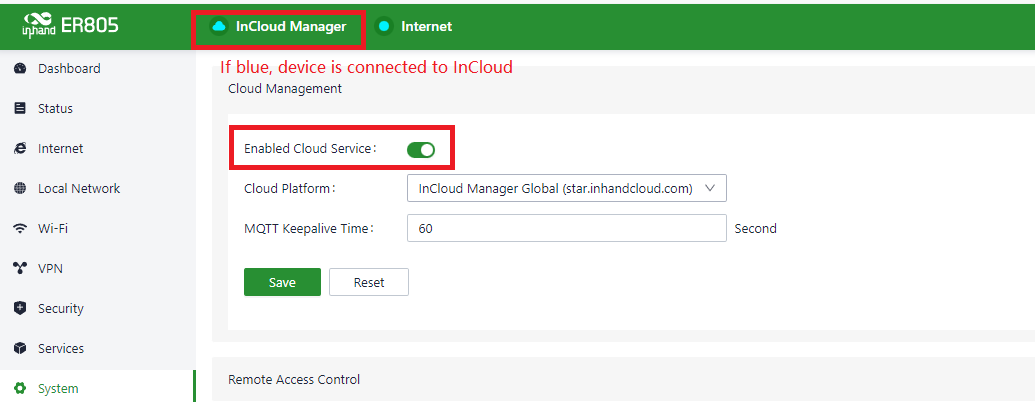

Connect the device on InCloud
1. Go to SystemàCloud Management. Enable Cloud Service should be checked by default, if not, please check it.

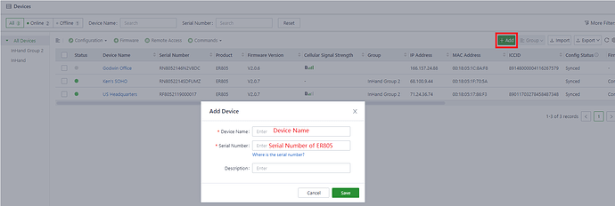

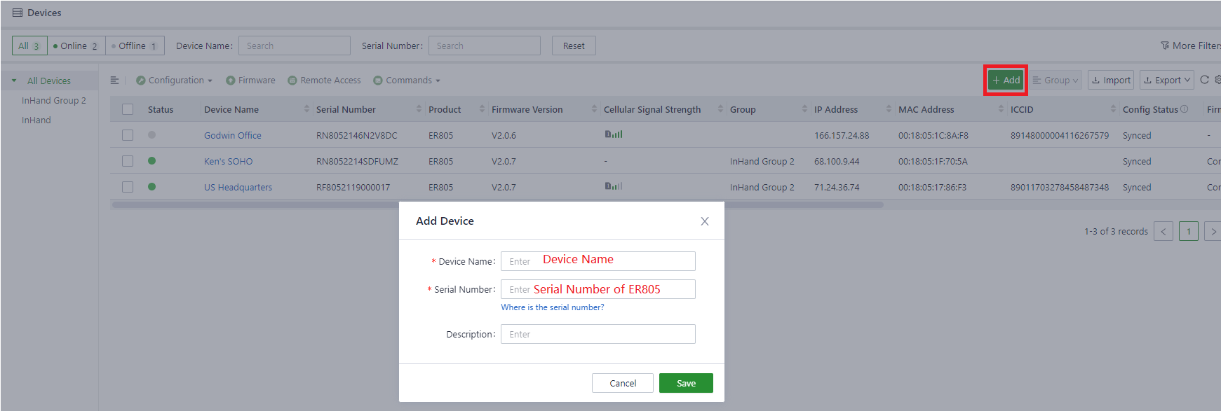

2. On InCloud portal, go to Devices. Click Add, then add device by Serial Number.
3. Wait for the device to show as online.
