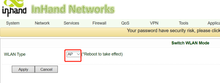

1) Select AP mode. Go to Network-> Switch WLAN Mode. The default mode of WLAN is AP. After the switch of mode, it needs a reboot to take effect.

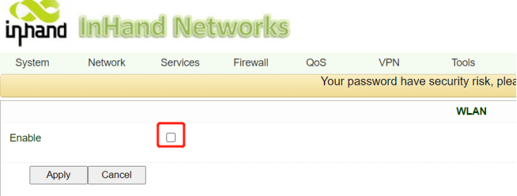

2) Go to NETWORK->WLAN. Enable WLAN functionality.

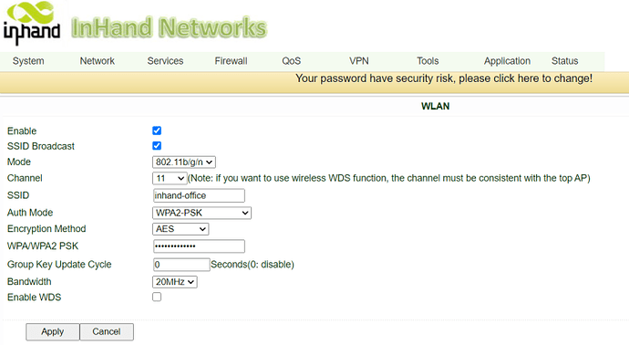

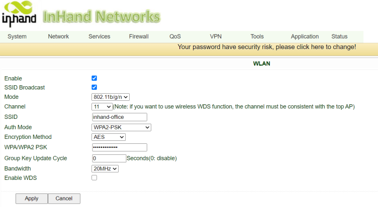

3) Change (if you wish) the SSID and the password.
