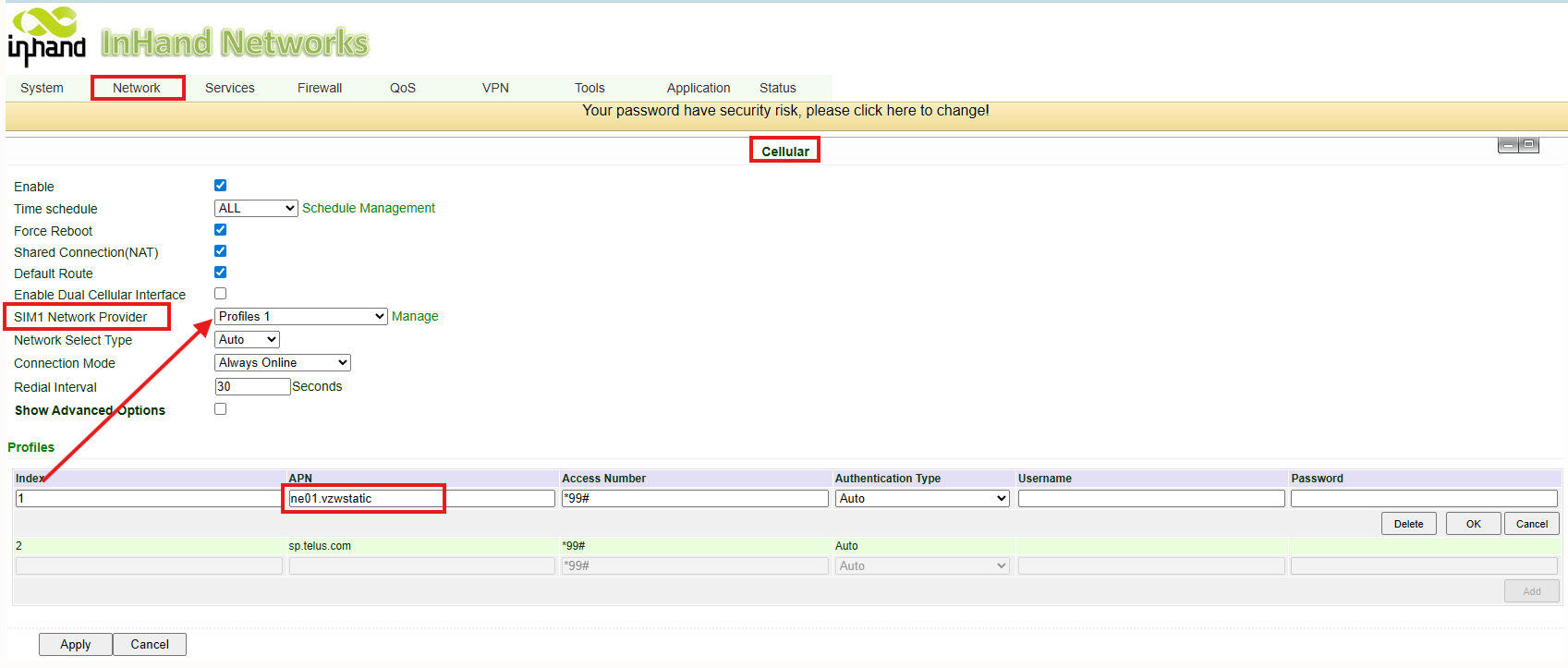

To manually configure the proper APN for a Static IP SIM:
  • Select the profile accordingly at SIM1 Network Provider. For example, Index 1 is Profile 1, Index 2 is Profile 2, etc.
  • Click Apply at the bottom of the page. The router will have a fresh registration to the cellular network after this.

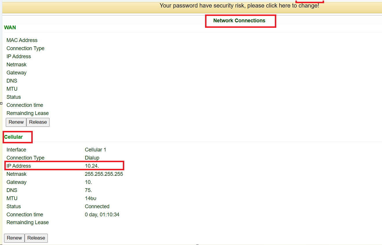

To confirm the IP assigned by the cellular network, go to Status=Network Connections. At the Cellular session, IP Address is the IP assigned by the network.
