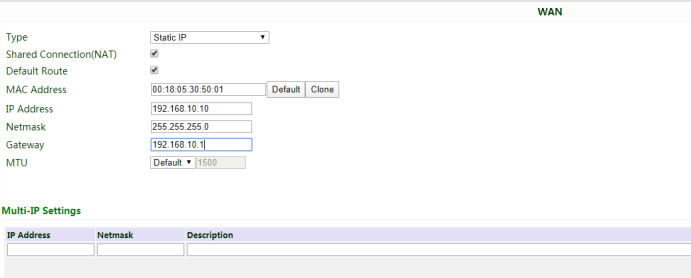

1. Go to Network >> WAN.We select Static IP for the WAN connection, and configure the WAN portas follows:

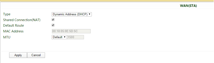

1) Go to Network >> WAN(STA), selectDHCP for WLAN connection.

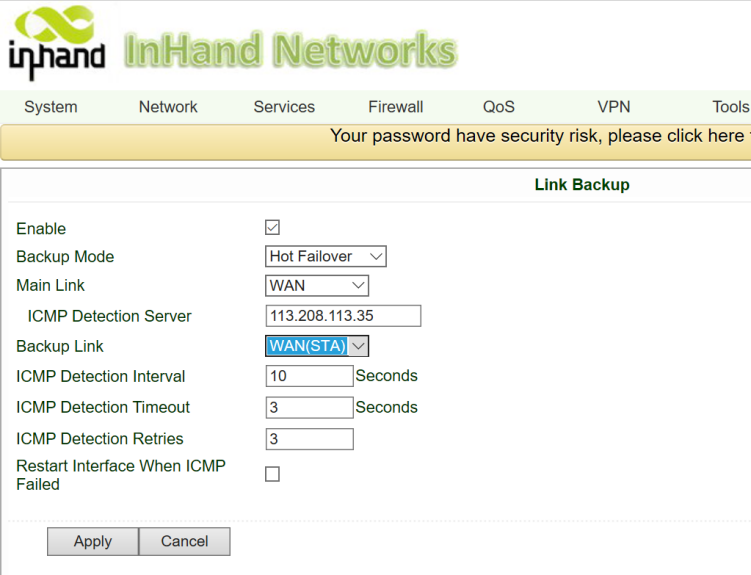

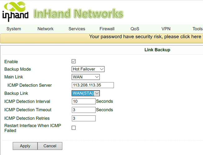

3) Go toNetwork >>Link Backup, set WAN as main link and WAN(STA) as backup link.

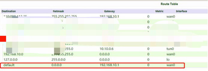

4) Check Status >> Route Table, you will see that IR302 transmits data via WAN port.

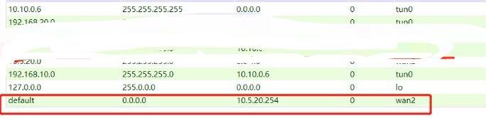

5) Test and Verify. Disconnect the wired cable.Check Status >> Route Table, and the default route has changed to WAN(STA).

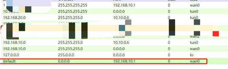

After the WAN connection recovery , the default route returns back to WAN.
