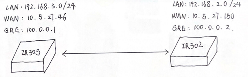

In this example, we give a very simple topology to make you easily understand how to configure GRE tunnel
Make sure that the two routers can PING each other successfully.
The topology after simplifying

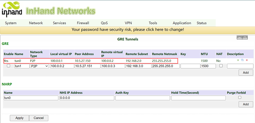

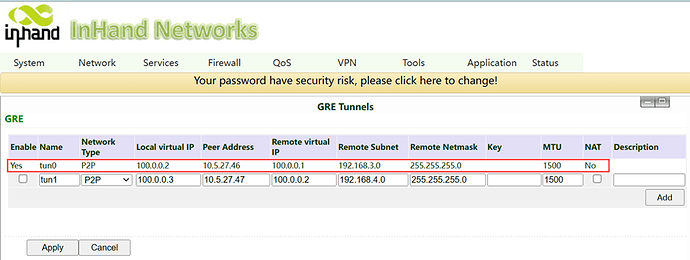

Configuration:
IR302

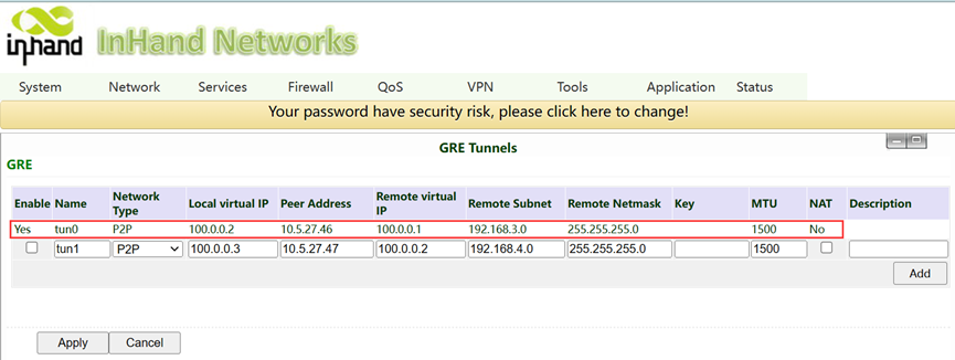

IR305

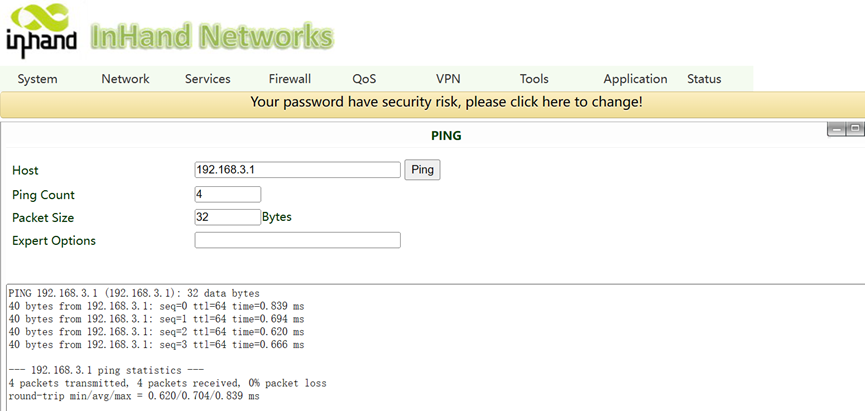

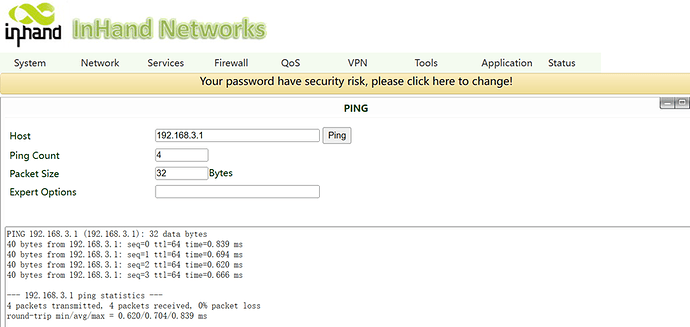

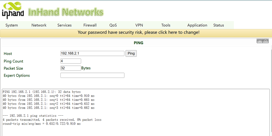

IR302 PING IR305

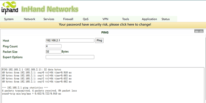

IR305 PING IR302
