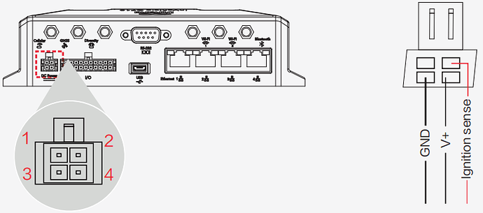

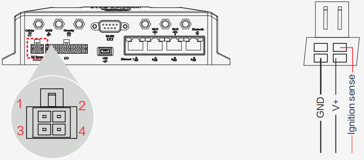

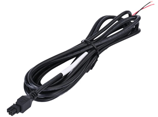

Power Interface
PIN
Definition
Color
PIN
Definition
Color
NC
2
IGT
White
3
GND
Black
4
V+
Red
In a normal engineering environment
Connect to the power supply V+, GND, and ignition sense cable. Connect the ignition sense signal cable to the ignition sense cable, as shown below.

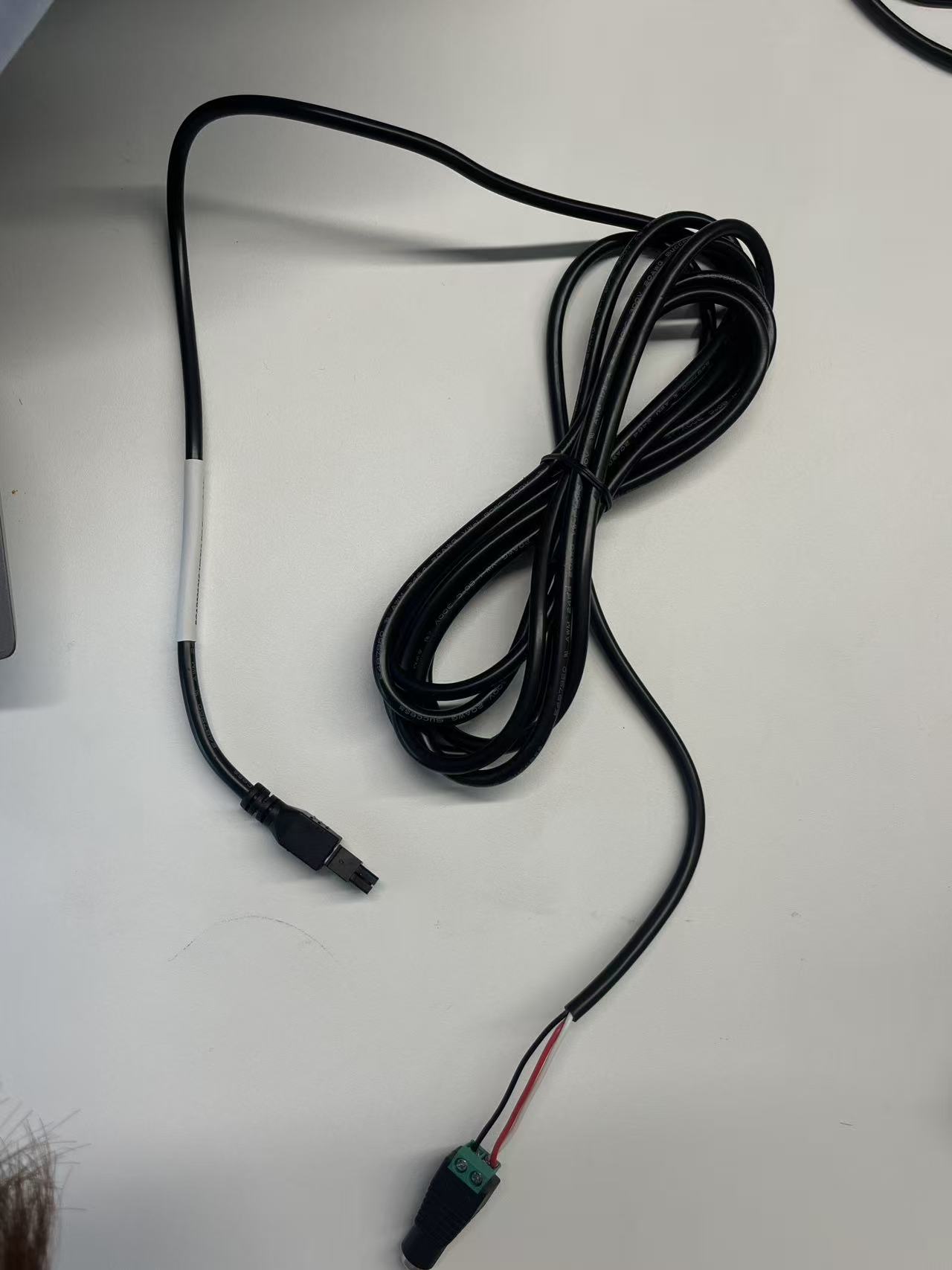

In a test environment(Indoor test in office)
Accessories

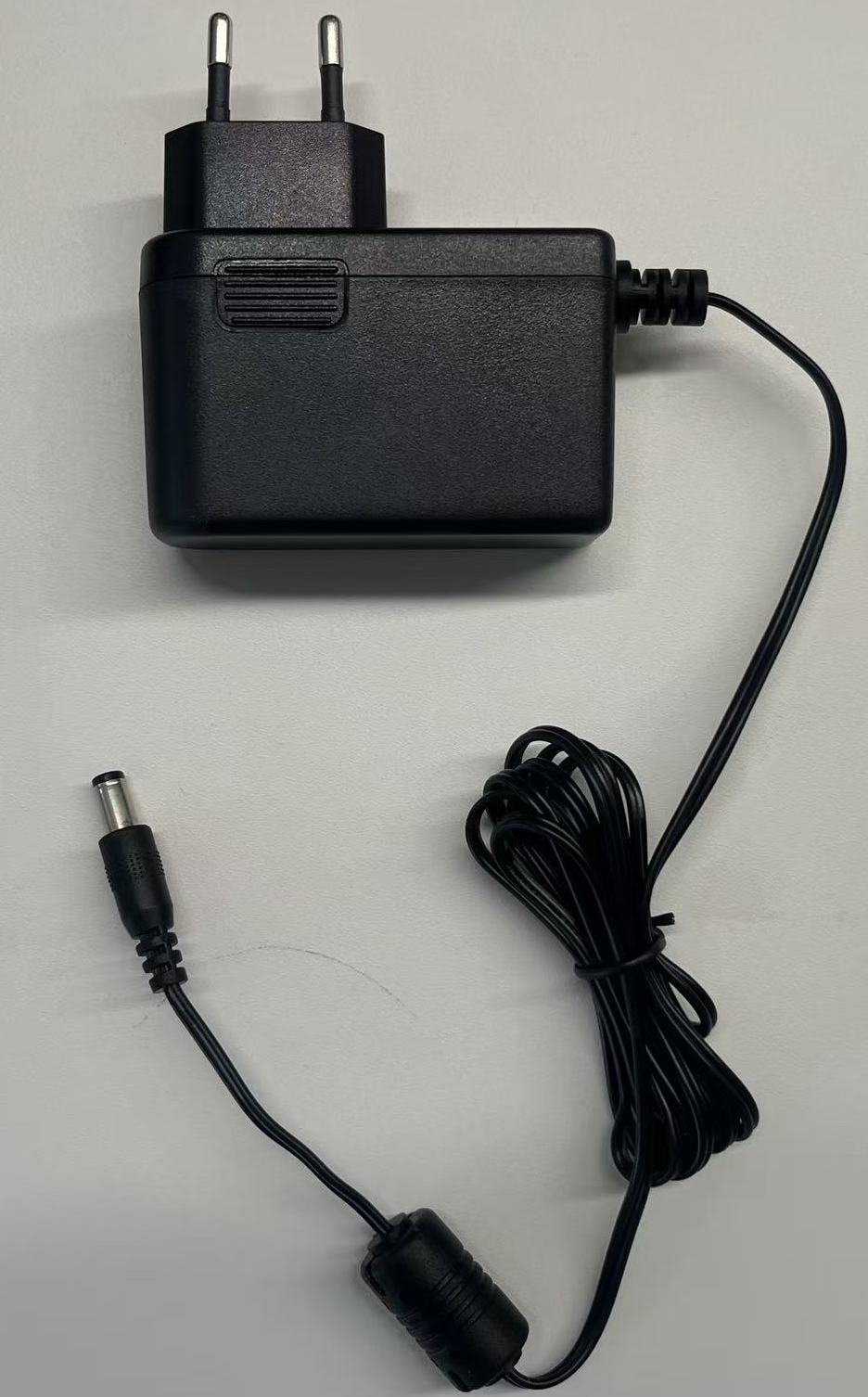

  1. Power Adapter

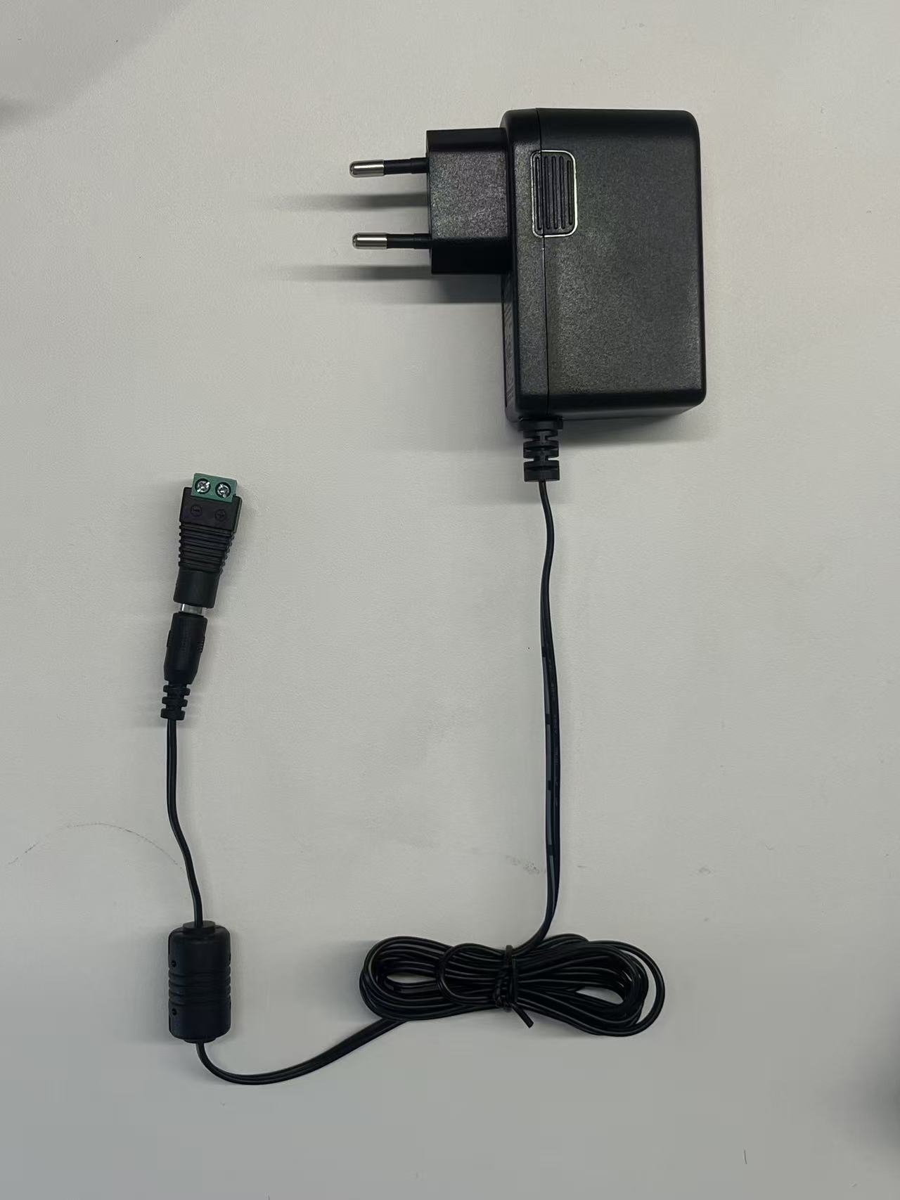

  1. DC 5.5*2.1mm Female Connector
  1. 4-pins Power cable

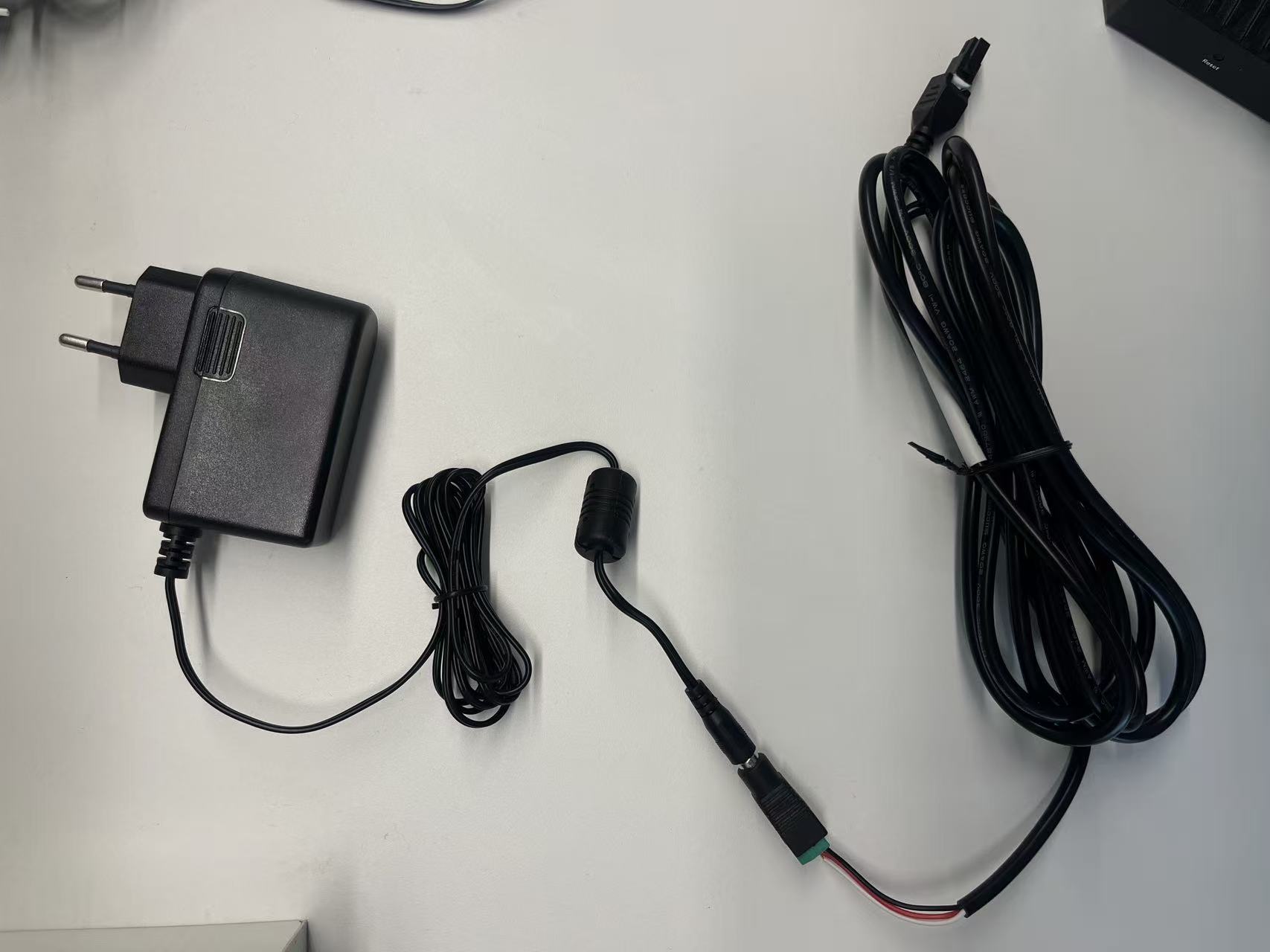

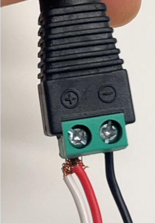

How to connect
  1. Connect the Power Adapter with DC Connector.
  1. Connect the ignition sense cable and the anode in parallel in DC Connector's Positive pin, and connect the GND in DC Connector's Negative pin.
  1. Combine the Power Adpater+DC Connector+4-pins Power cable. Then Plug the 4-pins Power cable's 4-pin side into VG710's power input interface, plug in the Power Adapetr.

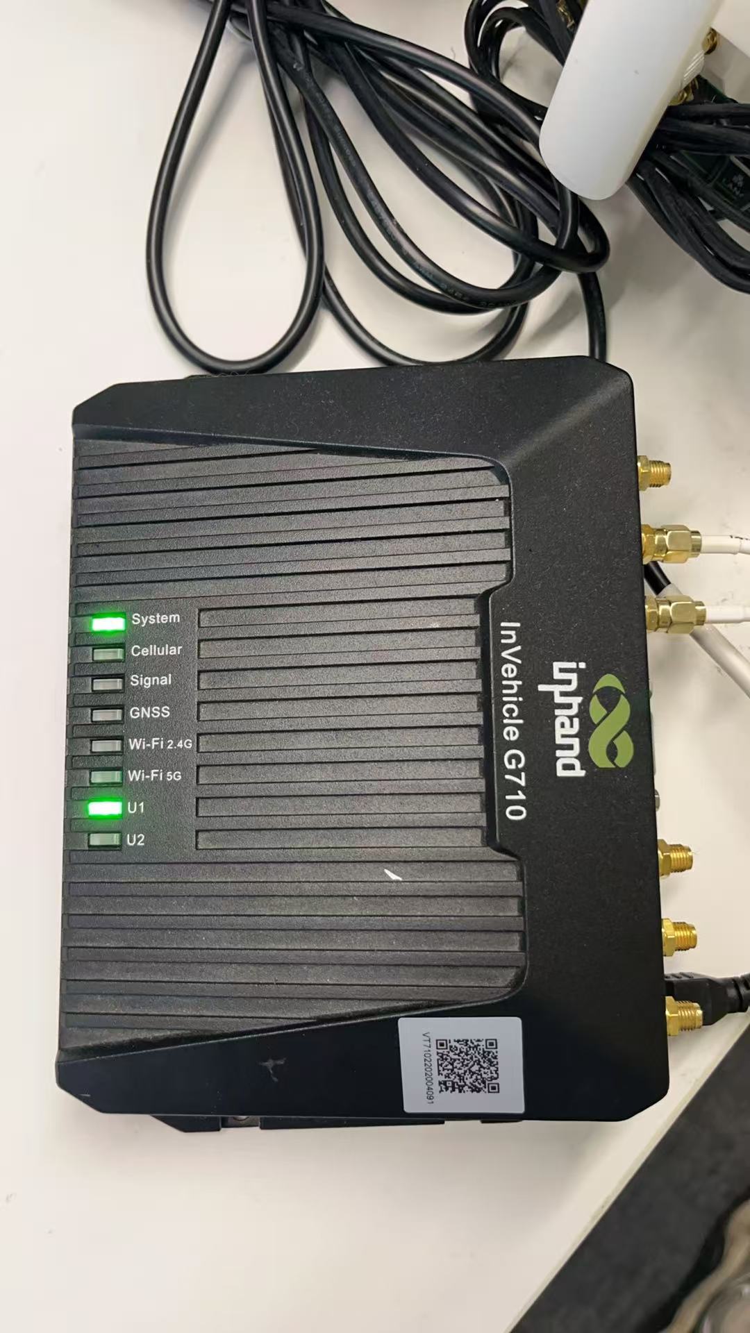

  1. Check the LED Status of VG710, which shows powed on successfully.
Note
The device cannot be started if the ignition sense cable is not connected.
