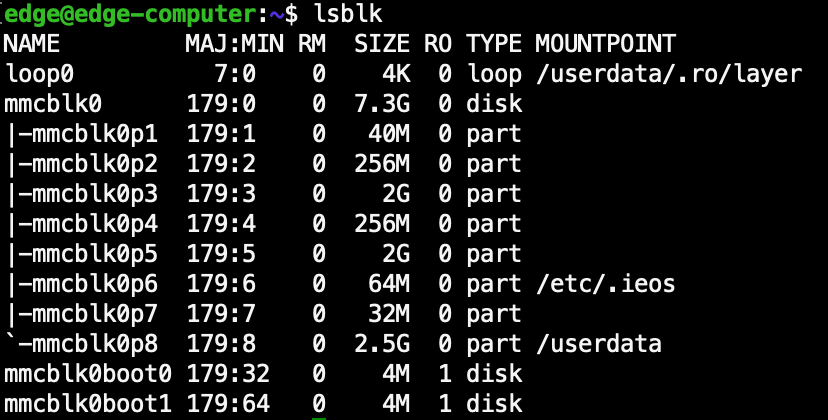

Question 2. Why is there only ~2.2GB flash for User on EC312 IEOS but the spec said 8GB flash
Answer:  The EC312 IEOS is a redundancy design for the firmware backup. With the A/B partitions, EC312 can roll back when any abnormalities or power outages during the upgrade process happen. Each partition is 2GB.
Here is the IEOS flash partition on EC312 1GB RAM+8GB Flash.
Partition Name
File System
Start Address
Stop Address
Partition Size
Notes
uboot
FAT32
12M
52M
40M
GPT bootloader
kernel1
EXT4
53M
309M
256M
kernel A Part: fitImage, modules, base-system, network-plugin
rootfs1
EXT4
310M
2358M
2G
rootfs A Part: Linux distribution root file system
kernel2
EXT4
2359M
2615M
256M
kernel B Part: fitImage, modules, base-system, network-plugin
rootfs2
EXT4
2616M
4664M
2G
rootfs B Part: Linux distribution root file system
configs
EXT4
4664M
4728M
64M
Configure information storage area for the OS, network, DSA
custom
EXT4
4728M
4760M
32M
Platform privatization deployment information file
userdata
EXT4
4888M
User partition, upper and work layer for overlayfs; Docker working directory;

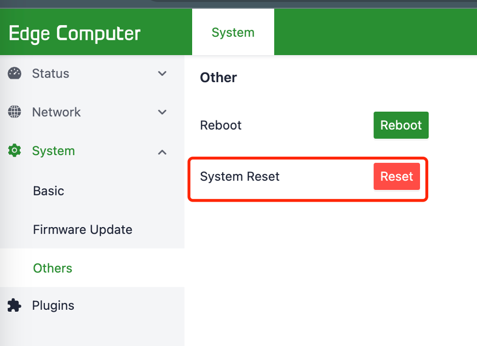

Question 5. When the System is reset from Web GUI, which partition(s) will be erased?
Answer: The “configs” and “userdata” partitions will be erased.
