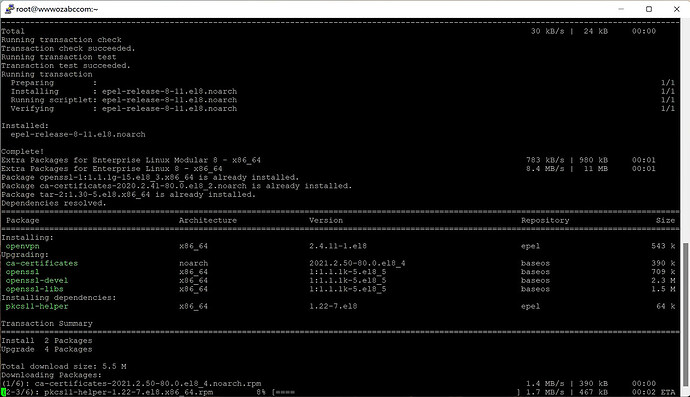

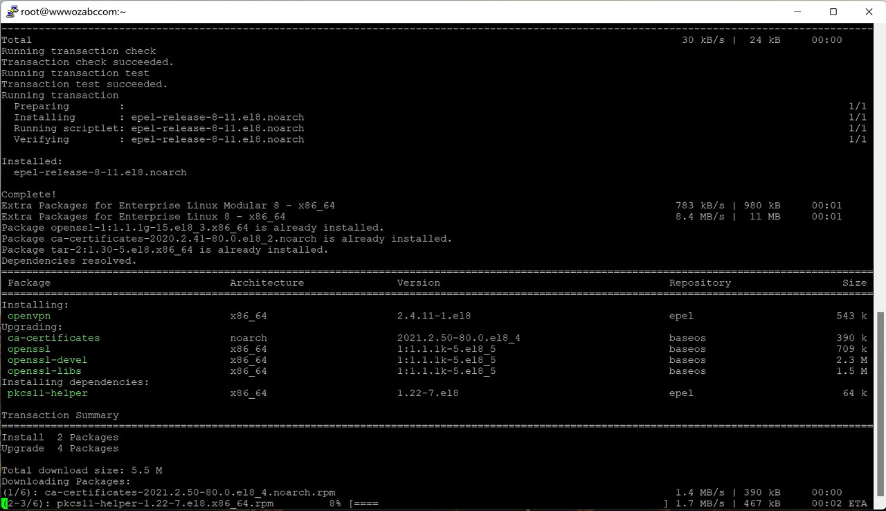

Download and install OpenVPN server for Linux (one click installation command)
Open source project GitHub
wget https://git.io/vpn -O openvpn-install.sh && bash openvpn-install.sh
Recommended UDP protocol: 1
Select according to the network environment.
After installation, export the opnvpn configuration file generated under the root directory through winscp, and then you can connect and use it on the client.

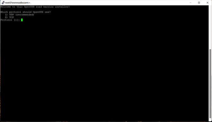

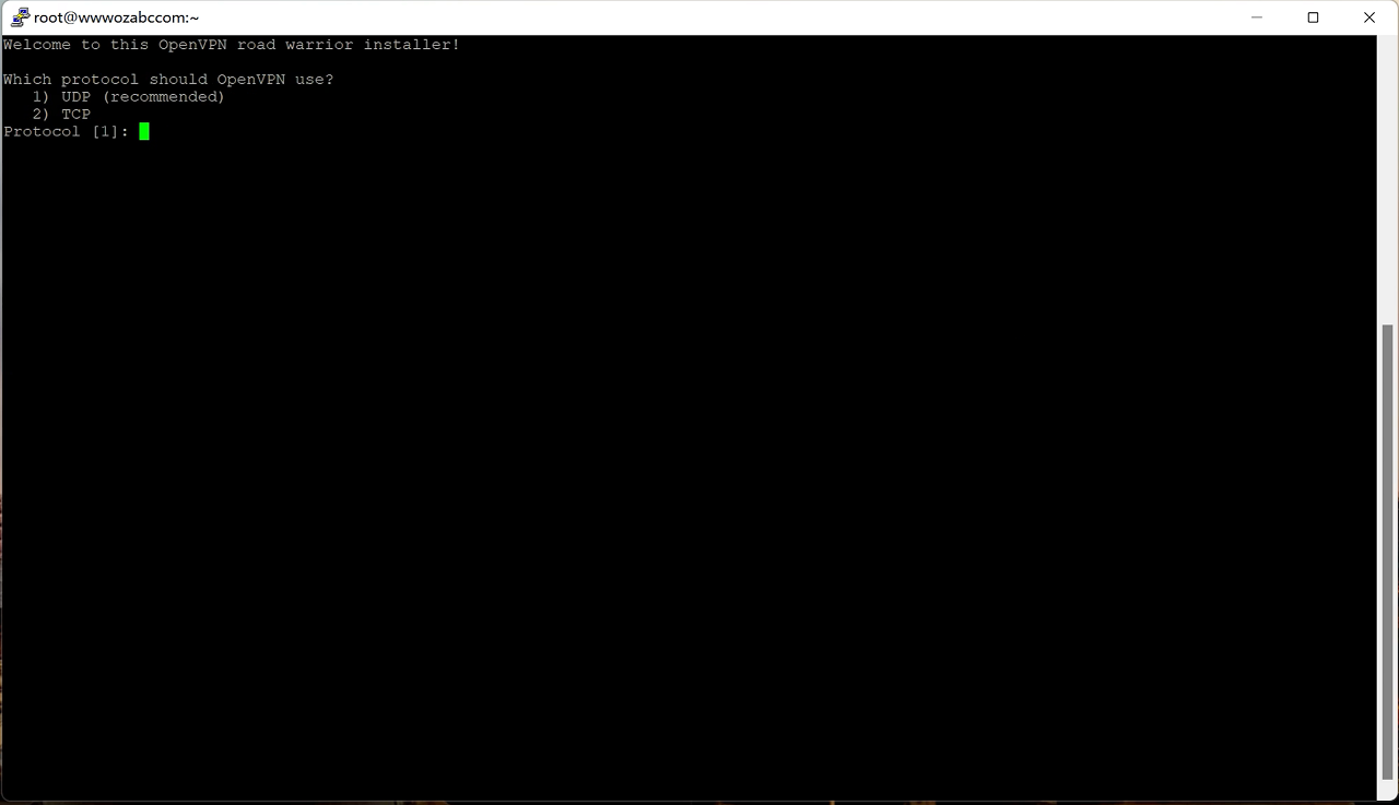

Which protocol should OpenVPN use?
1) UDP (recommended)
2) TCP
Protocol [1]: 1

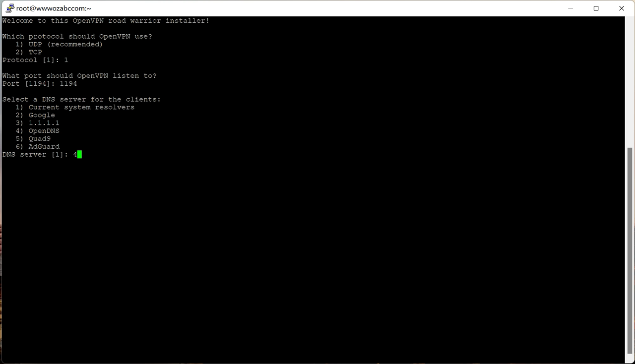

What port should OpenVPN listen to?
Port [1194]: 1194
Select a DNS server for the clients:
1) Current system resolvers
2) Google
3) 1.1.1.1
4) OpenDNS
5) Quad9
6) AdGuard
DNS server [1]: 4
