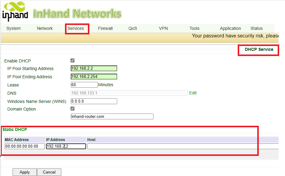

IR302 product is a setup option to allow the lease option forever?

Dear Customer,
The lease period can be set up to 10080 mins/7 days.
If the purpose of setting lease to forever to maintain a fixed IP address for a certain device, you could take a look at Static DHCP, which allow a fixed IP to be assigned based on MAC.
934×578 56.1 KB
