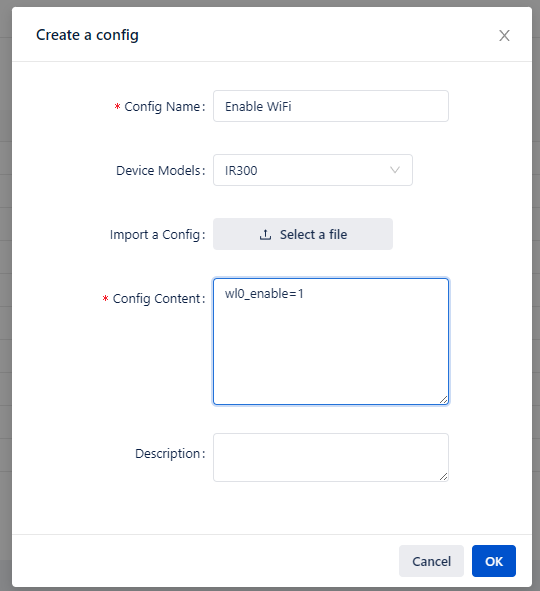

  1. Log in to Device Manager portal, go to Config, click on add+:
  1. At the creating page, put "wl0_enable=1" at the Config Content:

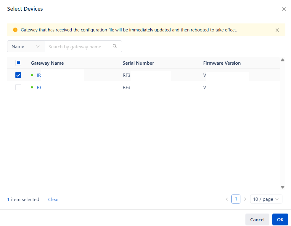

  1. Then select the target device:
  2. After the config is pushed to the devices, they will reboot automatically.
