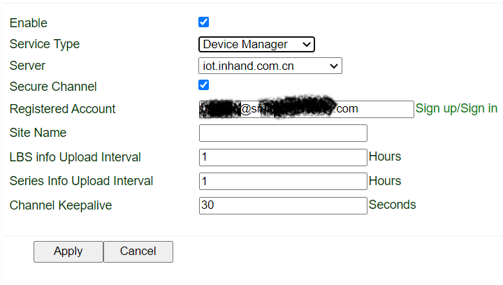

I have a cellular router IR615 ( with WLAN and WAN  connection )
Checking status led it seems connected but it can't register on device manager cloud.
Here the log that reporting following problem :
failed to perform http get,ret:60, reason:SSL peer certificate or SSH remote key was not OK
device register failed, retry with 714 times
This device manager setting .Is there something wrong ?
Hi, please change the server to iot.inhandnetworks.com.
