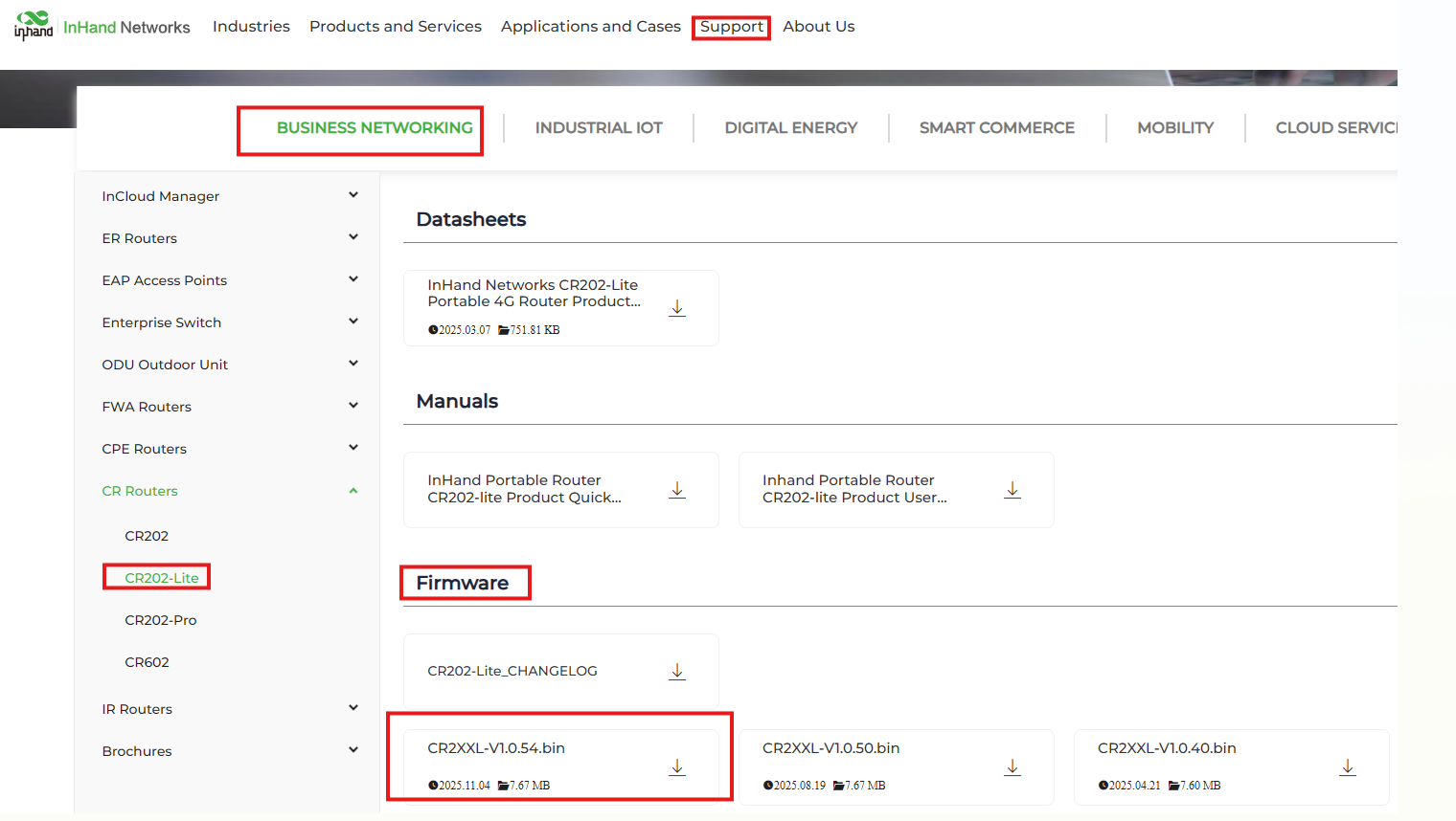

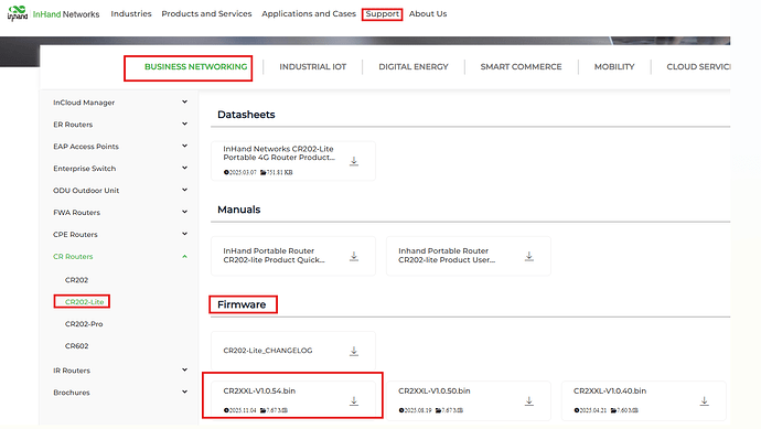

1. Download the latest FW image file from InHand website.

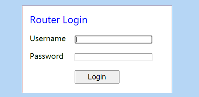

3. Access to the default IP address 192.168.2.1 in a web browser. The username and password can be found on the label on the back of the unit.

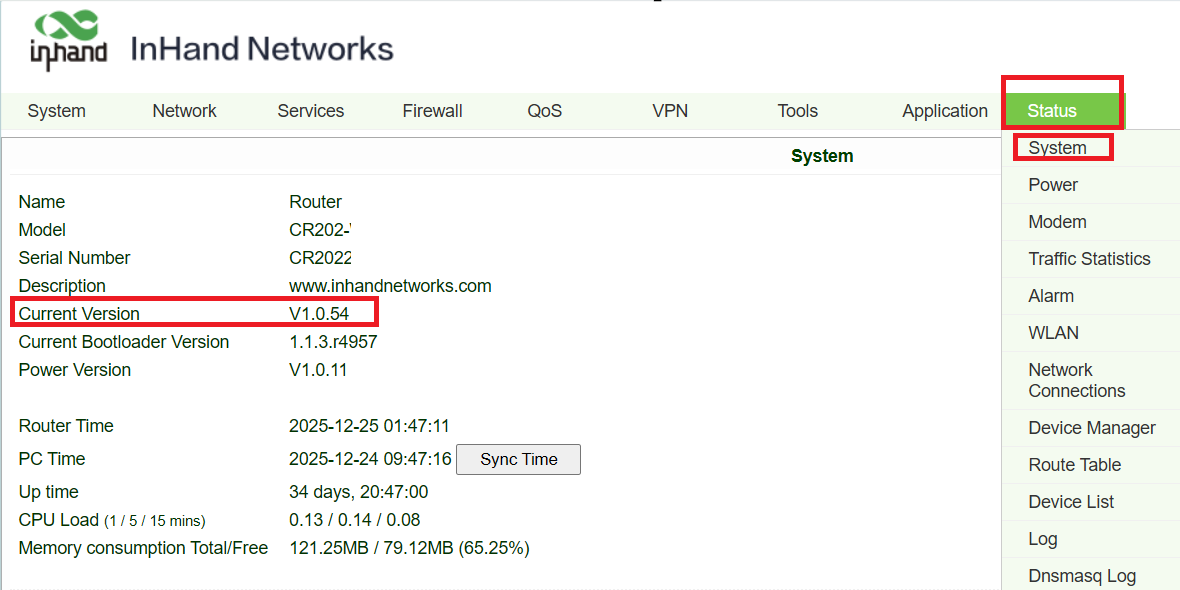

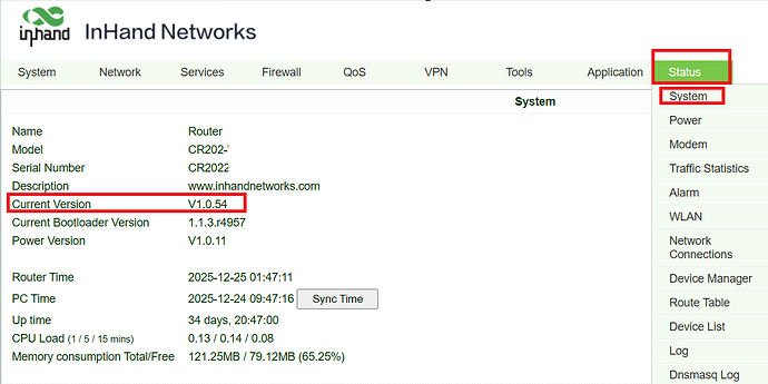

4. Confirm the Current Version at Status=>System:

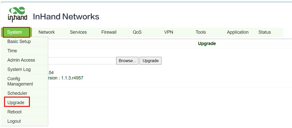

5. Go to System=>Upgrade page:

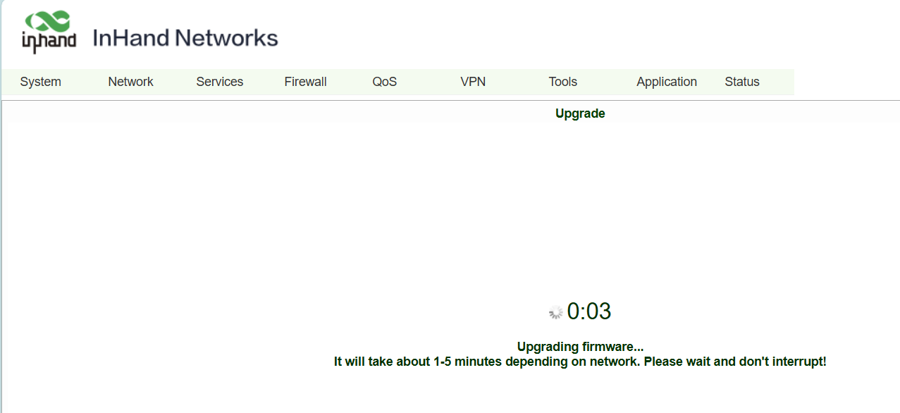

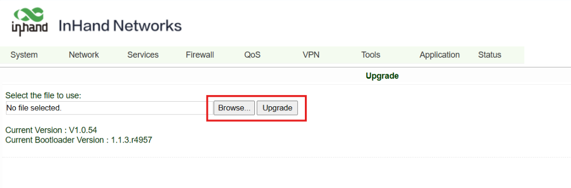

6. Browse the image file and then click Upgrade:

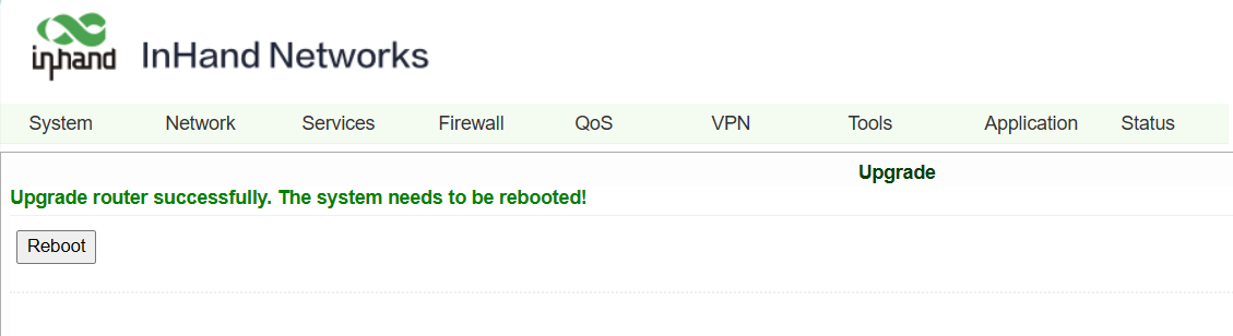

7. The upgrading process takes 1 ~ 5 minutes:
8. When the upgrading is done, please reboot the device.
