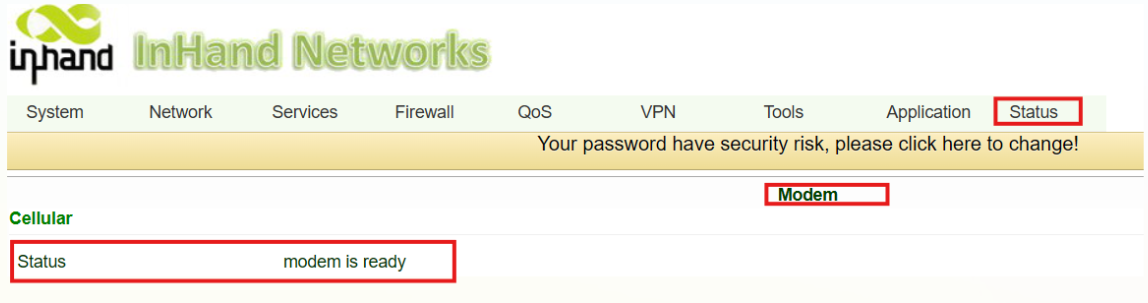

  2. At Status=>Modem page, the Status is "modem is ready"

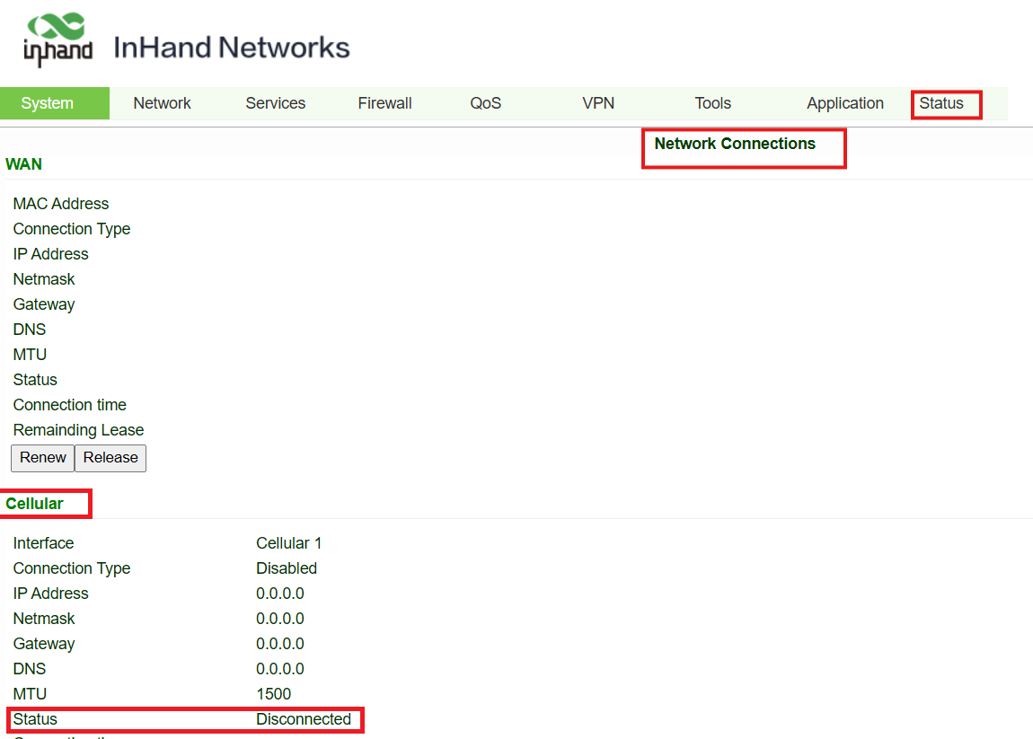

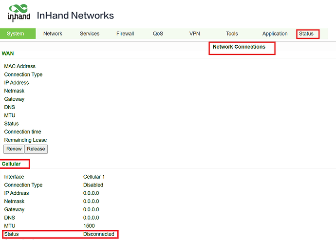

  3. However, go to Status=>Network Connections, the Status of Cellular is "Disconnected"

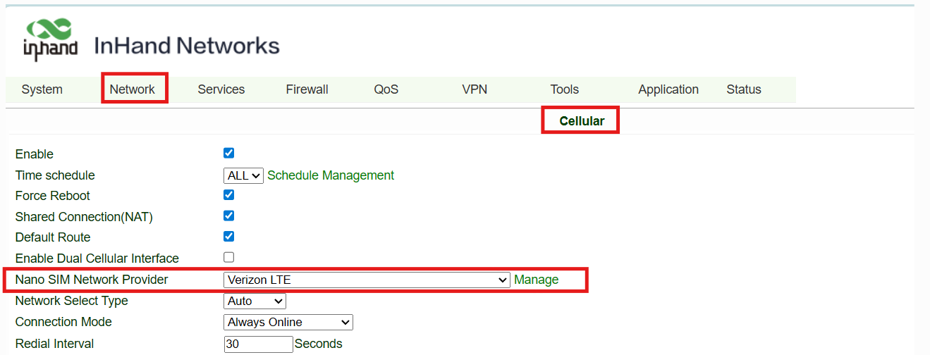

  1. Go to Network=>Cellular
  2. At Nano SIM Network Provider, select Verizon LTE profile:

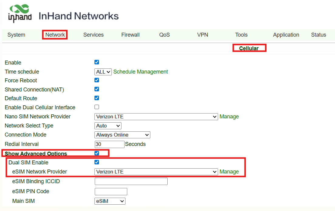

  3. If eSIM(embedded SIM) is used, please set eSIM Network Provider to Verizon LTE:
  4. Click Apply on the bottom of the page. The route will reboot the cellular modem to have a fresh network registration.
Please check the status of the Globe LED to confirm if the router is able to register. A stable Globe LED indicates the router connections to cellular network.
