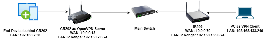

The topology of the demo:
In this demo, testing is performed within a local network environment. As a result, the CR202’s WAN IP appears as a 10.x.x.x private address. In real deployments, this would typically be a public IP address.
CR202
  1. Acts as the OpenVPN server
  1. LAN side connects to end devices (PLCs, sensors, controllers, etc.)
PC
  1. Acts as the OpenVPN client
(IR302)
  1. It's just a networking device providing Internet services to the PC. No extra OpenVPN setting is needed.

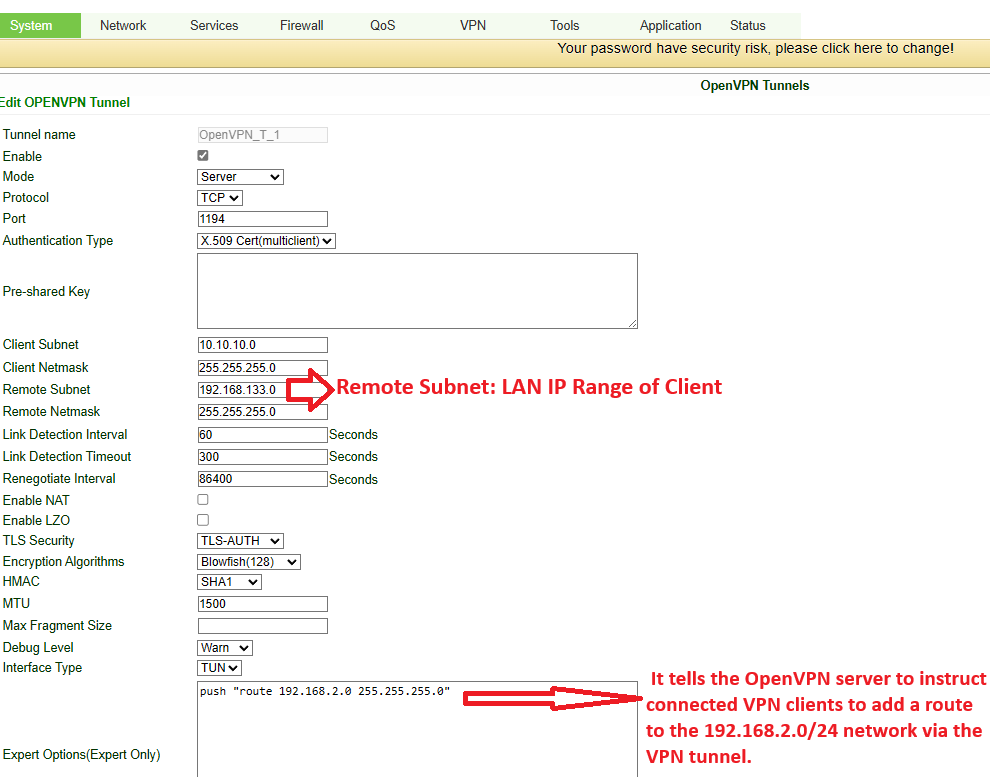

CR202 OpenVPN server setup:

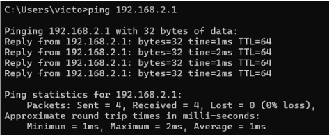

When the setup is done, we should be able to ping CR202's local network from PC:
