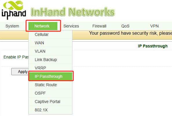

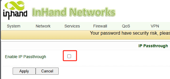

  1. Disable IP Passthrough:

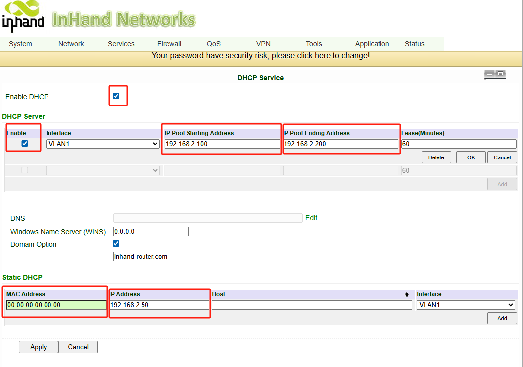

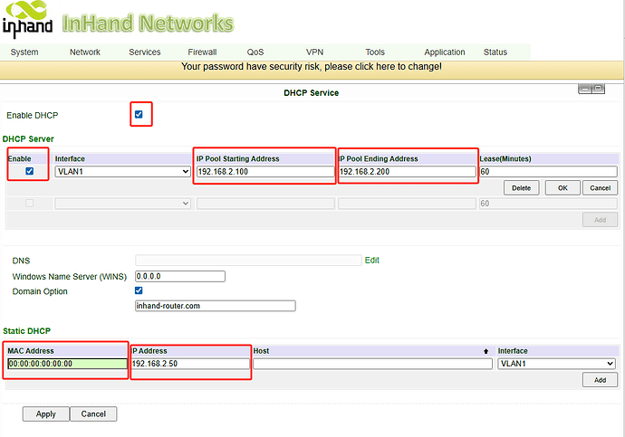

  2. Configure DHCP:
    • Purpose: Need to setup an IP pool for all the other terminals which don't need to talk to the service on the internet directly via IP, and perform regularly with internet access and sitting behind the rout

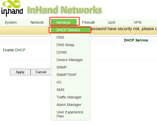

    • Navigate to Services >> DHCP Service.
    • Set the IP Pool range (e.g., .100 to .200) to leave room for static IPs.
  3. Set Static DHCP Lease:
    • Purpose: give the terminal(s) MAC their own IP addresses that can be directly visible to the internet, so the IP needs to be out of the previous setup IP pool, which were reserved for other regular devices. Otherwise when DHCP reassigns the IP addresses to the devices, the MAC address may lose its static IP address.
    • Scroll to the Static DHCP Table.
    • MAC Address: Enter the MAC address of your terminal (e.g., CC:82:7F:xx:xx:xx).
    • IP Address: Assign a fixed IP outside the pool (e.g., 192.168.2.50).
    • Click Add and Save.

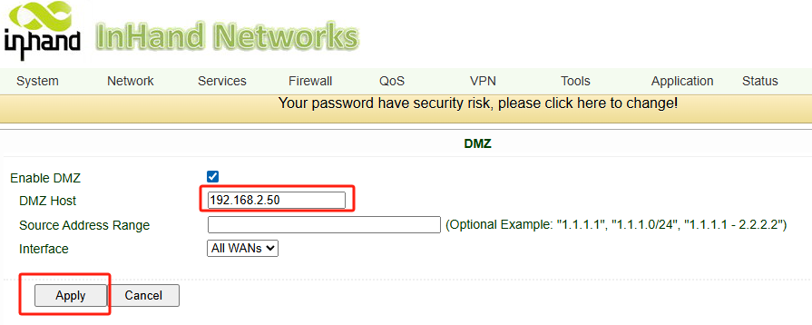

Step 2: Enable DMZ
Purpose: this is to open the router for incoming traffic can directly reach the assigned the terminal setup in previous DHCP fix MAC step. Basically it means, out of that regular DHCP IP pool, all other traffic can directly come to this IP address.

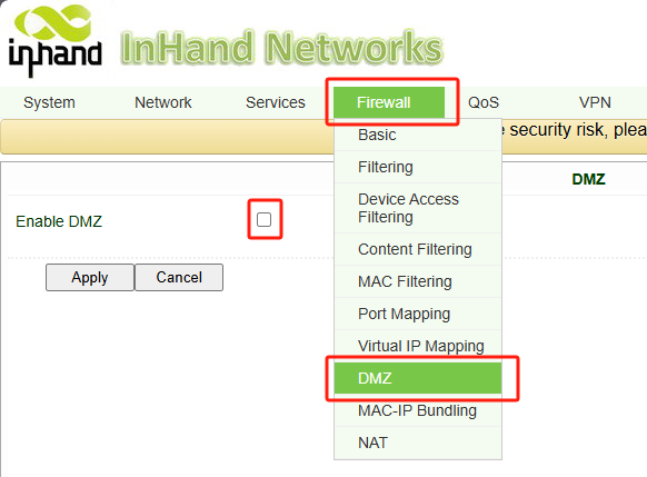

  1. Navigate to Firewall >> DMZ.
  2. Enable the DMZ function.

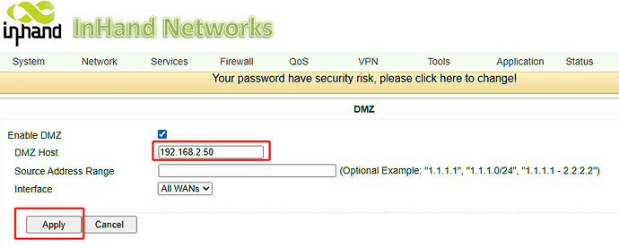

  3. DMZ Host: Enter the Static IP you set in Step 1 (192.168.2.50).
  4. Source Address: Leave blank (Allow all) or restrict to a specific server IP for security.
  5. Click Save & Apply.

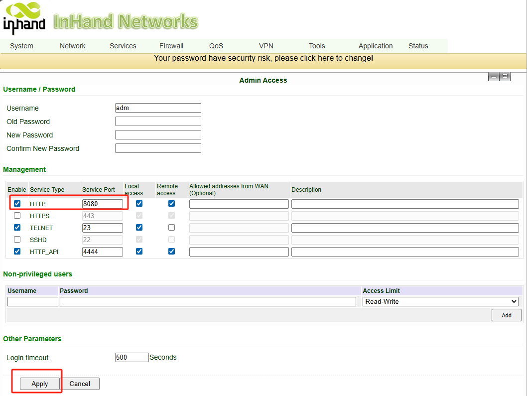

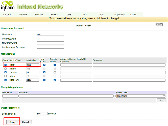

By default, both your appliance and the InHand router listen on Port 80 (HTTP). When traffic hits the Public IP, the router intercepts it for its own login page, preventing access to the appliance. We must move the router's management port.

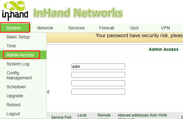

  1. Navigate to System >> Device Management (or Administration >> Admin Access).
  2. Locate HTTP Service or Server Port.
  3. Change the HTTP Port from 80 to 8080.
  4. (Optional) Change the HTTPS Port from 443 to 8443.
